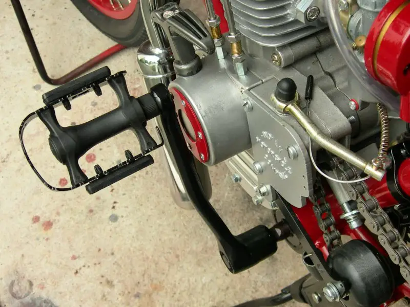

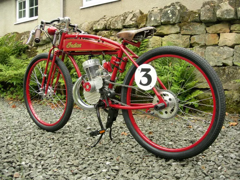

That'd be a 'yay' from me then.
No complaints after I fitted the same pull start to my Indian Board Tracker tribute.
Clearance wise, I solved the wide crank issue by welding an extra boss onto the left side crank arm. Neatest and cheapest solution for me 'cause I'm in the UK, where wide crank pedals aren't readily available, so buying a set wasn't an option. See pics.
FYI: I just recently saw wide 3-piece crank sets for sale on US eBay costing $18. Go buy a set and you're all sorted.

Man y’all are posting some beauties!!! Holy smokes those are nice looking bikes! Thanks for the responses!

Do you have any pictures or details on how you welded that left side crank? I’m not sure what a “boss” is. Also with the 3 piece crank set how do you know if it’ll fit my bike or not? I am getting ready to put a Zeda80 kit on a Huffy Nel Lusso cruiser I bought new from a big box.
Sorry, no pics showing how I reworked the left side pedal. Easily explained tho...
My bikes feature 3-piece cranks. In this instance, the "boss" I referred to is nothing more than the end of the pedal crank arm which fits onto the crank shaft (in my case a longer 3R crankshaft). I simply cut off the boss from a spare crank arm I had lying around and welded it onto my left side crank arm - effectively doubling the length of the boss and spacing the crank arm sufficiently outboard to clear the pull start's casing as shown in the pic I posted.
I'm not sure if your nel lusso has a 3-piece crank. Maybe it has a one-piece crank. In either case, the simplest way to solve your problem of pedal clearance is to swap-out your bike's existing crank set for a wide crank set. However, it's worth pointing out a wide crank set will space-out both pedals when you really only need the left side pedal to clear your bike's pull start. Which was another reason I opted to go the route I took.
