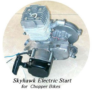

electric starter
when is this coming out? i just grabbed this picture from the grubee site
Well, you see, that's the thing, I think Grubee has already developed these products but not all of them are imported to the U.S. So unless you're a dealer, you probably will never have a chance of getting one
