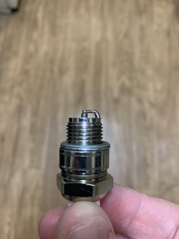

What is safe to use to bend out the little arm without breaking it? Would like to keep it as a backup. But for now will probably just get a new one.

That S/P ya have is fine just gap it.
Yes, buy another NGK S/P for back up.

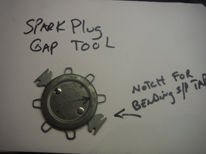

A S/P tool is best, as it has a little notch on it to bend the little S/P tab.
But you can bend the little S/P tab up with any thing ya got handy. Just don't pry against or put pressure on on the electrode or ceramic insulation as ya might break it.
The wires are different gauge size for gaping spark plugs
The notches are for bending different thickness S/P tabs
As you can see i have the .025" gap wire marked with an arrow as that's the one I use most.
