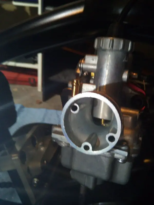

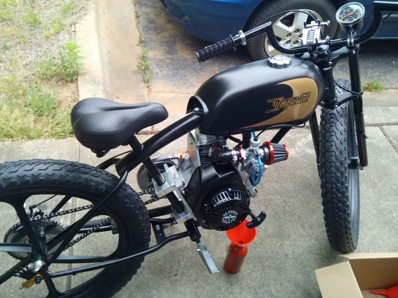

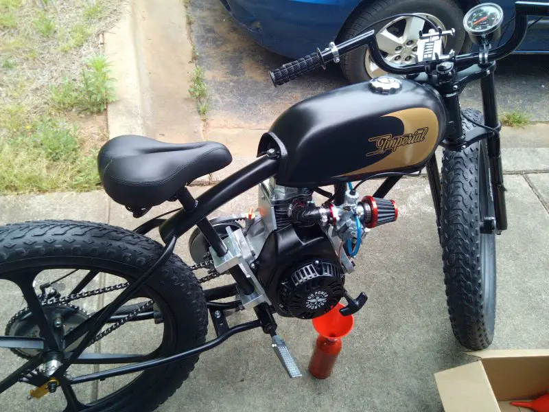

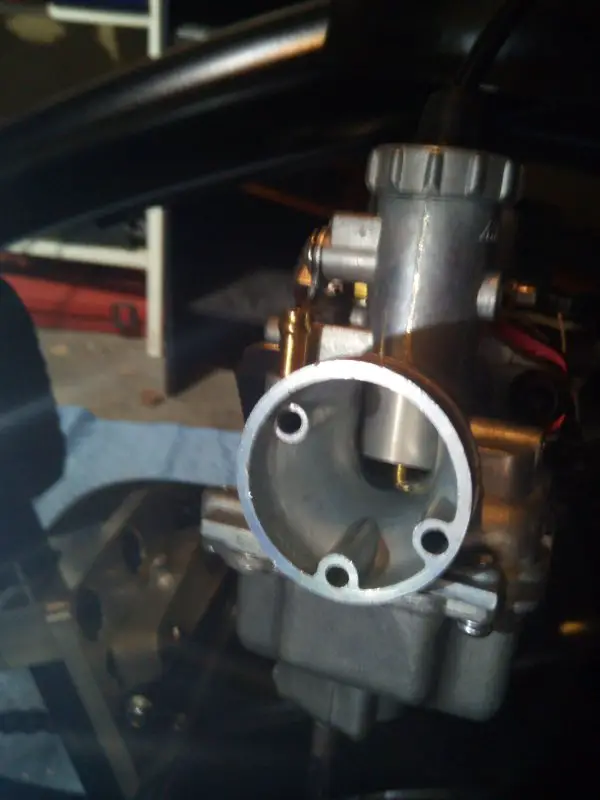

So, there i was, carried the beast down the stairs of my apartment - 7 months of building and dreaming in my office space, and finally the day has come. Threw oil in, some gas, went to start it up, BOOM gas i dripping from the carb filter. That issue was resolved quickly - realized i ran the fuel line in a vent hose rather then fuel nub. Dang, i felt stupid. Anyway, took the carb apart (brand new) but i did so to make sure the jet looked fine, and the floats were functioning propery. Put it all back togther, changing the angle of the carb so that it lays more leveled, using a radiator hose and clamps for good compression. Turned on the fuel, and nothing leaked. Made sure fuel was reaching the carb, turned the choke on, pulled the starter a few times and nothing at all. A few more pulls, still nothing. Super bummed out. Put ALOT of work and money unto the bike. These are the troubleshooting steps i took so far. Following a lot of what the manual says but basically.
Engine wont start -
-carb not primed -- pull on starter handle to prime
-carb needle stuck -- tap side of carb (take apart carb)
Testing electrical issues
--Unplug spark boot, pull starter, does spark
--unplug spark plug, inspect, visually clean, brand new plug
>>The spark is there so it cant be electrical
Compression related
-loose cycl head or damaged gaskets (hissing noice )-- no hissing noise
-engine valves or rappets mis-adjusted or stuck -- made sure alignment was there when putting case back on
-compression lost due to leak in intake manifold--re adjust carb set up, fastening with radiator hose and clamps tighting intake.
So as you can see, pretty much went through everything we can without out take the crankcase back off and checking the alignment and timing. Not to sure whats going on. We went ahead an tried to spray fluid into the carb, while pulling the starter, and still nothing. It turns with ease, sounds like it wants to start up, then doesnt.
the only step i havent attempted is
-too much fuel in chamber, caused by carb needle sticking --
Turn Choke to RUN position.
Remove spark plug and pull the start
handle several times to air out the
chamber. Reinstall spark plug and
set Choke to CHOKE position.
Any suggestions ? View attachment 104329 View attachment 104330
