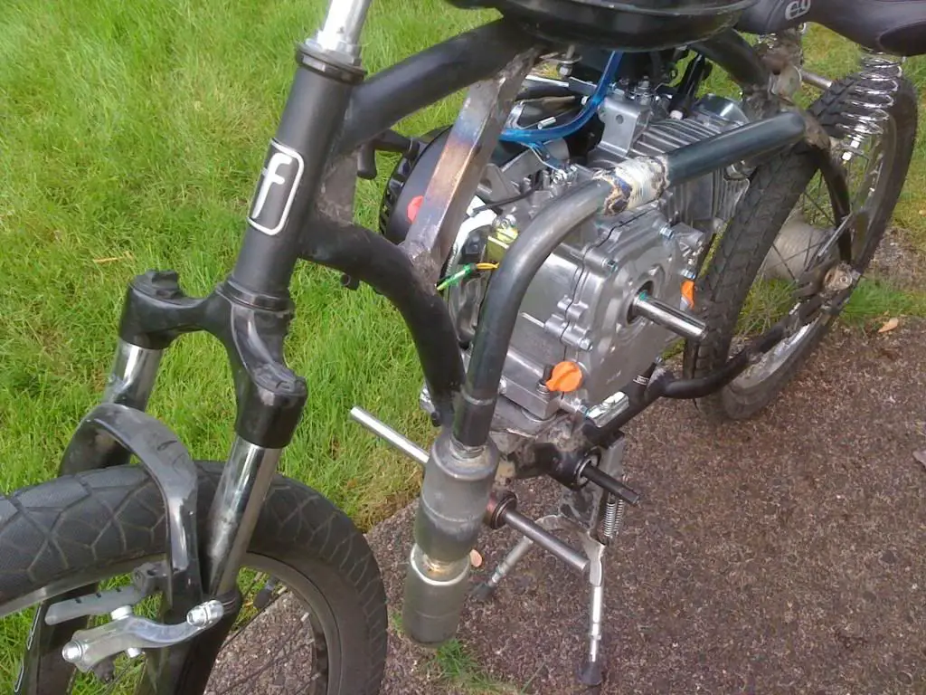

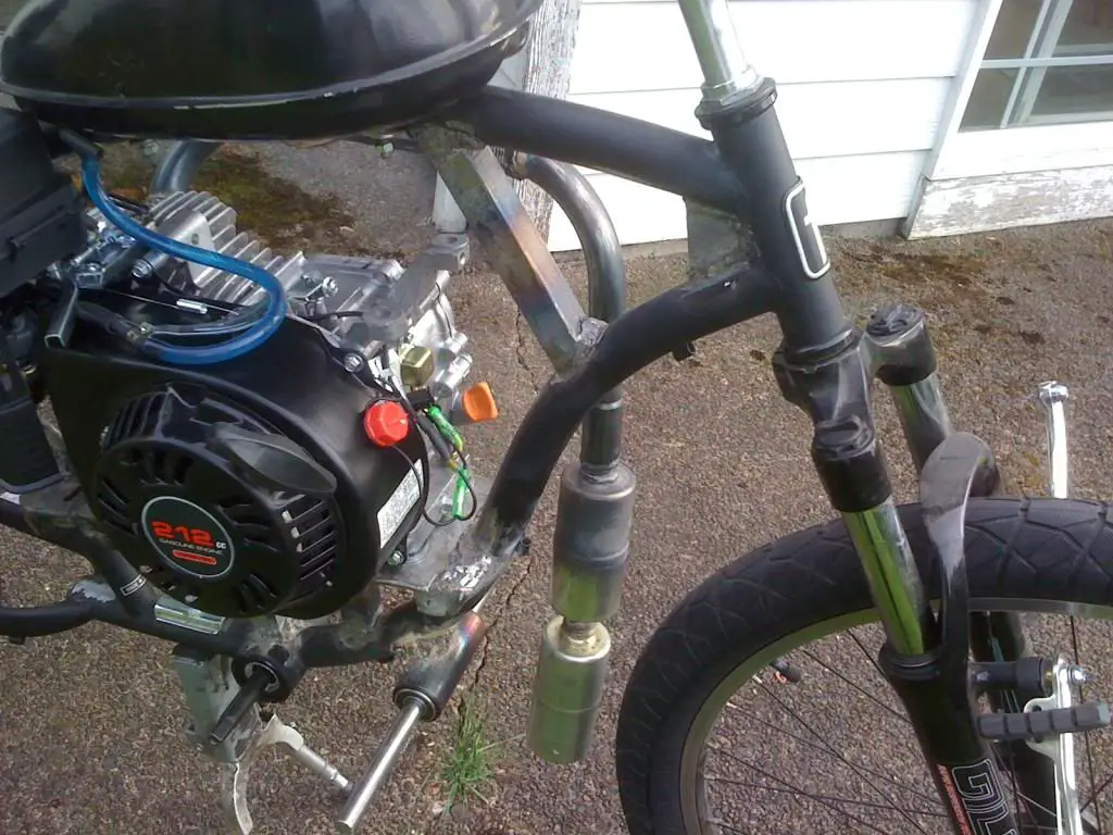

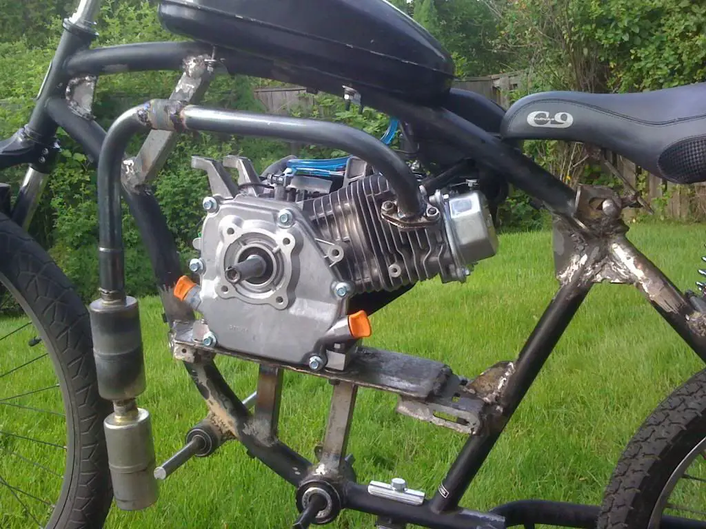

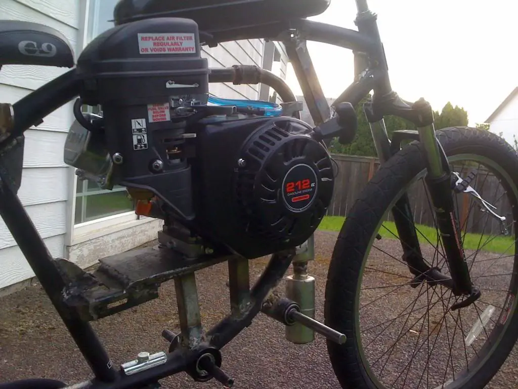

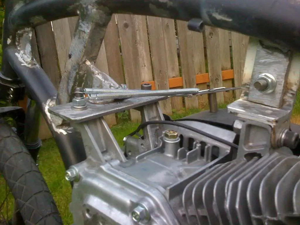

Anyhow, here's the setup the motor mount is welded to the frame, with 2 support bars, one connecting to the bottom bracket, the other about 2.5" infront of it. Another support bar about 4" behind the headtube. 3 small gussets right at the seat, and one at the head tube.
I guess i'll grab some pic real quick.
Don't mind my welding, it's just chicken droppings for now.
I didn't have the rubber isolator on this one motor as I wanted a baseline first.

A couple pics of motor mounts

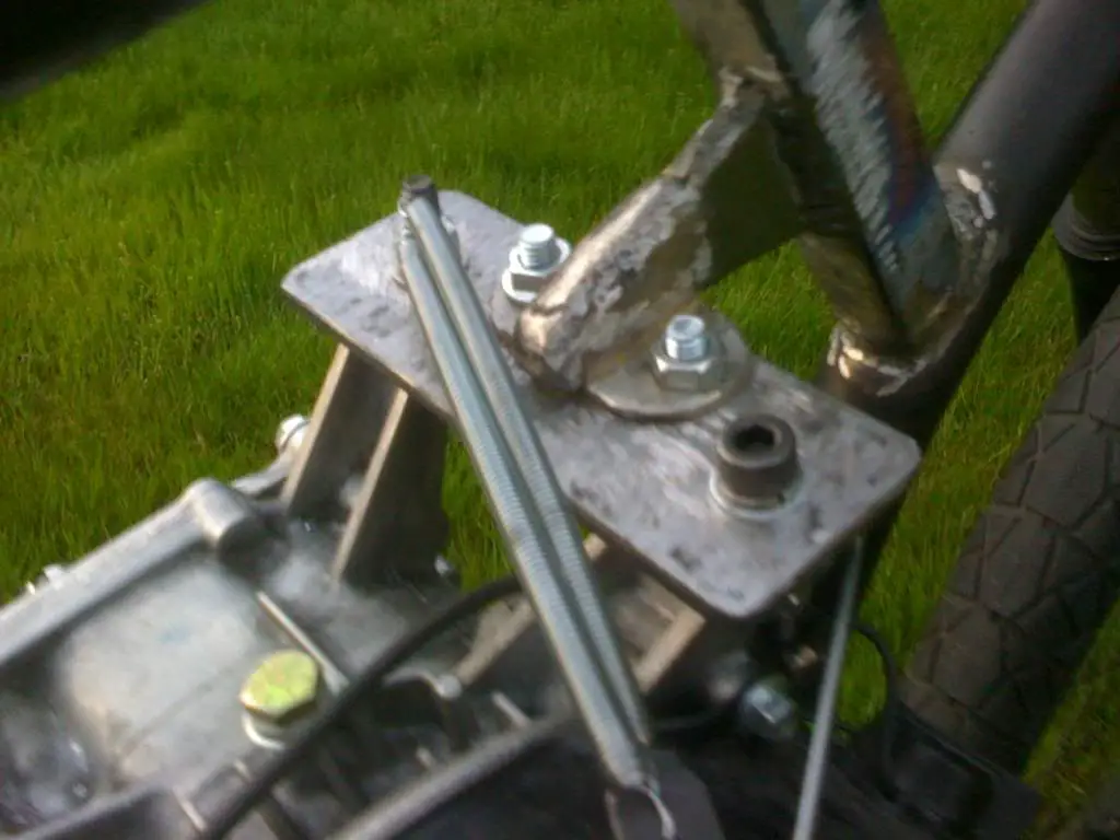

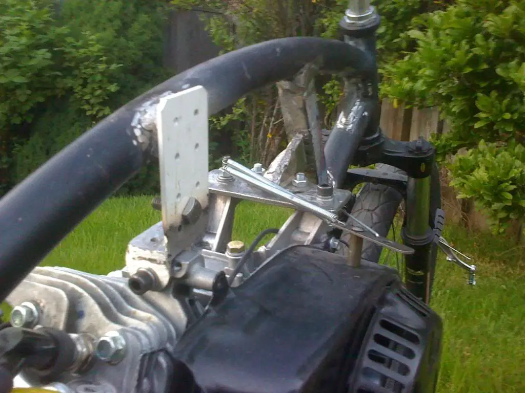

CCC, i think you are definitely right on the securing the motors on top and sides. I took a wrench and started tapping the sides of the motor mount with out the motor installed. I felt the vibration on the sides a lot more then when tapping the around the center of the mount. What I also found were gussets area had the least vib, and the support bar by the head tube didn't seem to do chit. But i'll use it for the top mounts though. I'll tap it with the wrench tomorrow and start feeling for vibration location on the frame. I'll add bigger gusset next to where it vibrates most. I'm betting it's gonna be the top tube and the rear triangle.
And of course I just remember I beat the crapped out of the crank shaft to remove the stock flywheel too, so that probably did some damage to the shaft which cause excessive vibs. Gear puller this time around to keep the shaft intact.

Please let me know if this is adequate mounting/bracing to prevent vibration.
Rear gas tank mount
I'll don't have any bracing on the left side of the motor yet though.
Added another mount to the heatshield mounting location on the left side, started her up and it idle w/o vibration... But with 1/4 throttle turn and it vibratate a little now. Does this sound normal to you guys?
added bracing for the exhaust
