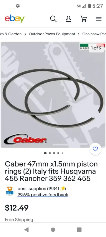

It depends what size motor you have. You just have to take it really easy when putting them on. Start on one end and work your way around the ring on the piston til it drops in place if you have a 2 stroke (that's all I have experience with) If you have a 2 stroke motor you can easily find parts on ebay for really cheap. You probably won't find them in an auto parts store. I have a couple sets that I keep for spares, but I know you can find them online very easily if you have a common bike motor kit engine.
The size of piston rings for the stock 66cc/80cc 2 stroke are 47mm
Good luck! And I usually do them by hand just like I said. You just gotta go slow and barely stretch them out while sliding them around the piston
I got the basic version as far as I know and its an 80cc. I dont have the measurement tool so I am not 100% on the size.
Would it be a difference if it was 46mm?
If it says it's for the 80cc motor 9/10 times it's the right piston ring on Ebay at least. I believe the rings are 46mm for the 47mm piston because of the ring sitting on the piston itself.
