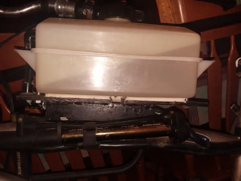

platic tanks are great i use what i call the saddle bag tank . kinda like a side tank but it only works with diaphram carbs , with the medal tanks made for the gravity feed carbs , i never mount them with just a single clamp pulling the studs out of the bottom of the tank happens from this . at the least it will make them leek . what i do is use a double set of clamps around the top tube with long 6mm studs going up then i thread 6mm extension onto the tank bolts with lock nut above that now just line it up and screw the tank onto the 6mm studs coming up from your clamps . an added benifit is one less vibration to worry about . the tank doesnt rattle against the bike . you might be able to see it in this picture this tank is the extra large tank from dax.com . very nice tank . the cap fits good but doesnt come stock with extra clamps you will have to ask for that .
townie picture by thescooterguy - Photobucket

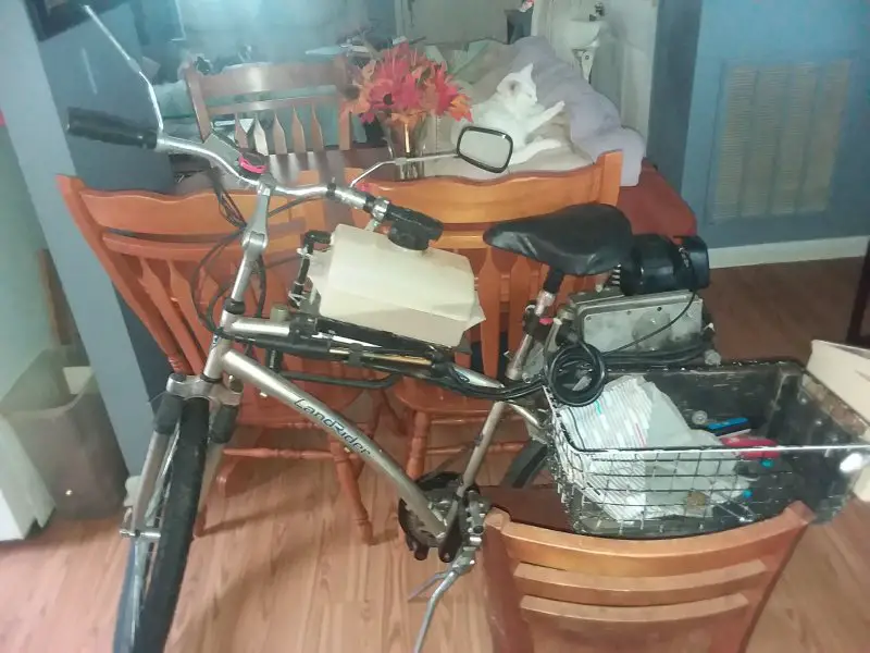

I got tired of the darn tank falling off or slipping, leaking, and more, so I just pulled one from a parts lawnmower and put a emongous clamp on it to the seat post and BAM, problem solved, looks cool and out of the way!

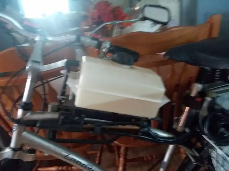

try this Bro, works great and I took it off from parts mower and clamp was free!
They still have em on Ebay free shipping. I would have liked to had that available 6 years ago and now I thought maybe change to bigger that this would be good. I was thinking looking at the mounting is it just the two tabs with a slot cut away. What kink of thickness is there for the mounting tab plastic, if you know?
Around 3/32 of an inch.
