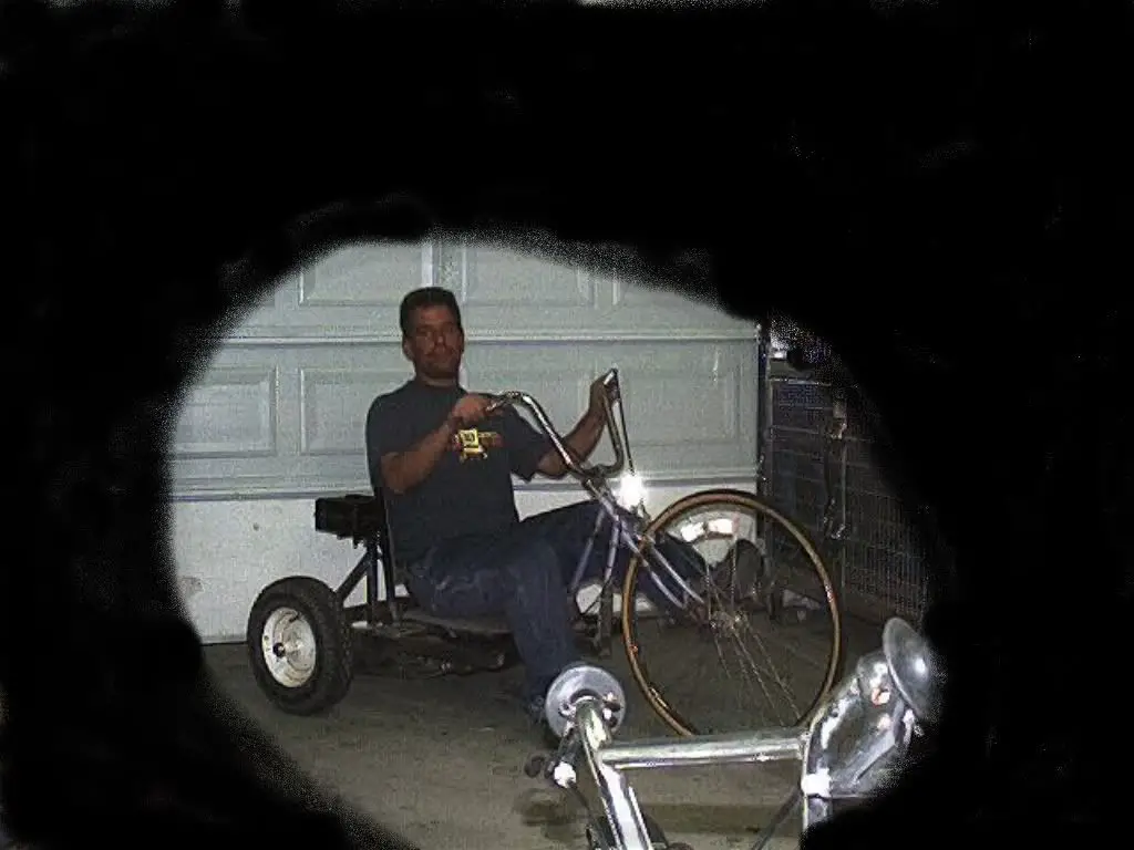

I got stranded one time with a gokart with cent/clutch and a broken pull-start. Jammed about 4 or 5 pop can tops into the bell, and gave it a shove- took a few tries, but it has been done. Once the motor fires, the bits go flying. This is the gokart.
...a very short video of it in action.
https://youtu.be/zCX2mwjTdd0
....ah, the Glory Days!
