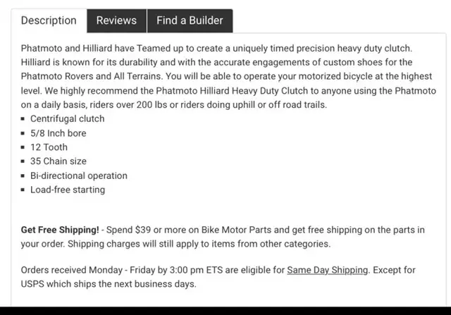

Phatmoto is offering a heavy duty aftermarket clutch custom designed by Hilliard just for the Phatmoto bikes. If it’s anything like their Kart Racing clutch it’s going to be a huge improvement over stock. Phatmoto Parts
https://www.phatmoto.com/collections/parts/products/phatmoto-hillard-heavy-duty-35-clutch
