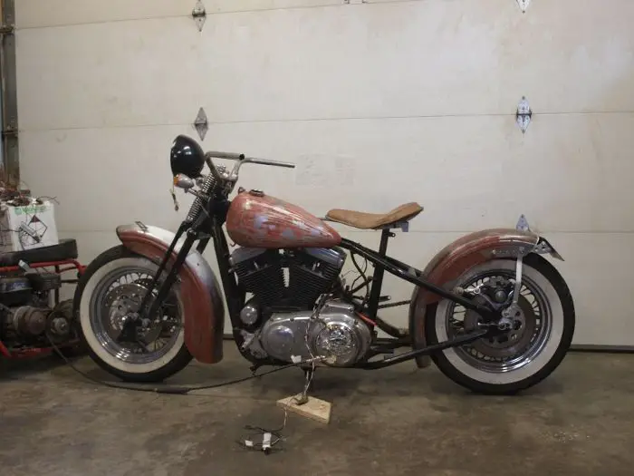

This is a frame I built up for a sportster engine that I've been very happy with for both handling and comfort so I'm going to use its basic dimensions in regards to seat / peg / handlebar locations relative to each other but knock it down from a 62" wheelbase to around 52" and use some curved tubing to hug the engine and hopefully make it look less small filling a tighter frame.

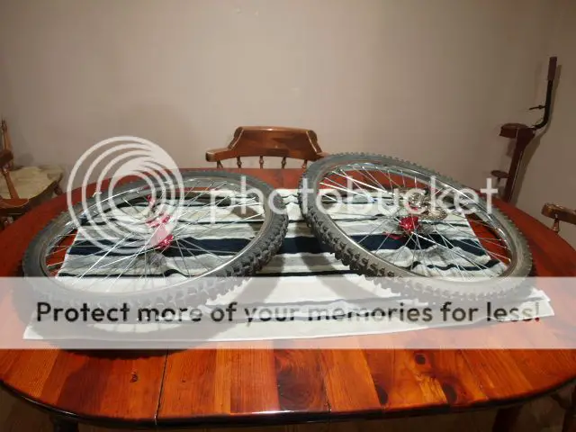

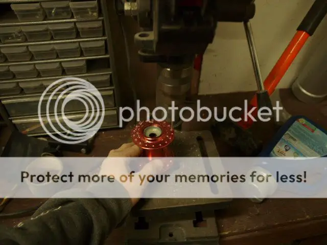

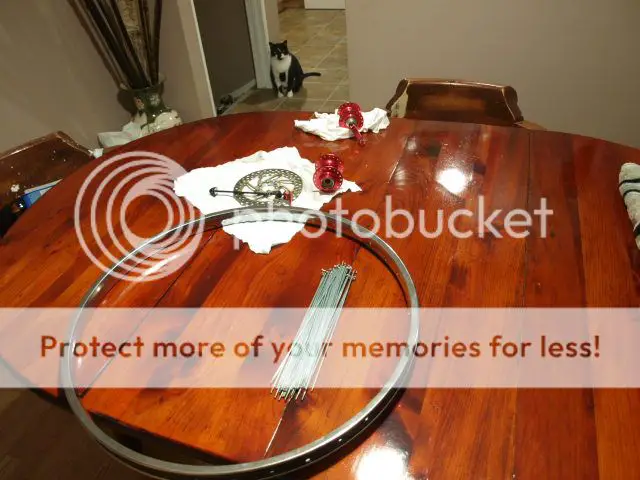

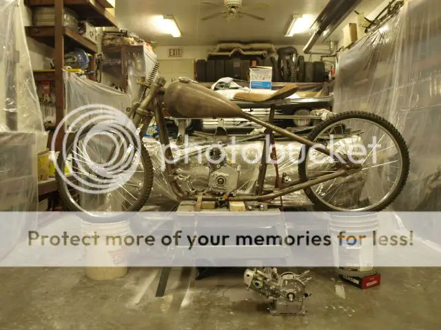

To get this project started I'm going to need some wheels. For this I went with worksman wheels and some cheap Ebay disc brake hubs I've drilled out for 12G spokes. I will be running the drive sprocket on the disc brake mounts and Ive picked up some freewheel adapters to run the rear brake disc. It was a bit of a gamble ordering these worksmans with shimano freewheels hoping the spokes would be equal length and fit the hubs that where slightly larger. Everything worked out fine and I have at least one set to get the frame started.
