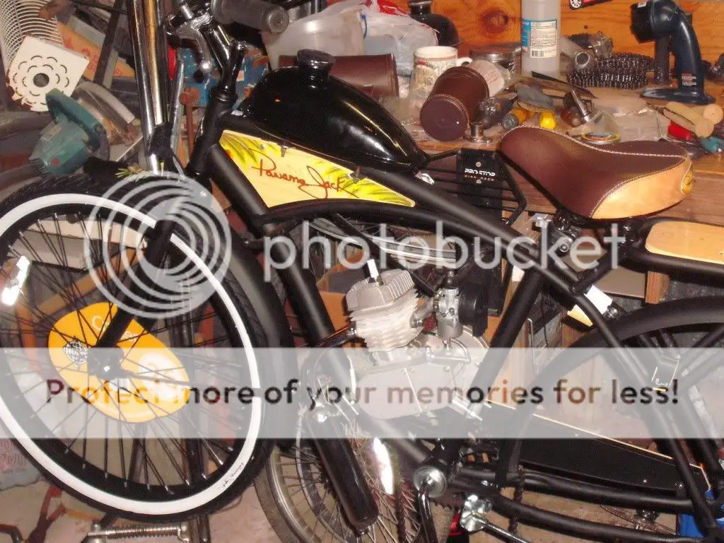

This is the build that I completed this weekend. You will want to trash that seat that with the bike, its garbage, the seat rails bend like they are made out of rubber! I also painted the tank flat black to match the rest of the bike and the rear sprocket.
How did you change the grips with the throttle ?
well, the grips come off with a little air pressure from a compressor and an air nozzle, the throttle is the one that came with the kit and the seat is from Nirve.com along with the shock seat post.
I'm planning on building on the Panama Jack beach cruiser. Can you pleawse tell me what modes I will have to make. Will the engine mount without adapters? If n ot what adapters will work? How did the rear coaster brake arm accept the drive sproket? Did you bend or replace it?
I had to bend the brake adapter. Most else mounted just fine. The skyhawk motor I got mounted with no modification other than pounding the bottom tube a bit with two hammers to allow the mount to slide on. The extra body tubes where the gas tank mounts can cause problems with the fuel switch. The whole switch popped off at the tank when I tried to mount the bike onto a car rack. The only real problems I'm having is with the engine kit itself. My carb arrived doa. Hope all that helps.
