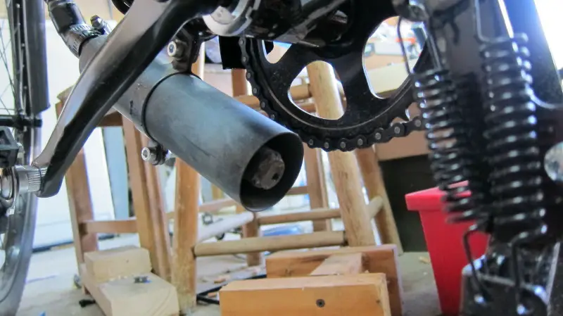

What I saw when I got home
The muffler is still on there good, but the back of the grubee tubee isn't.
But now it's on forever.
I like my torch - :)
