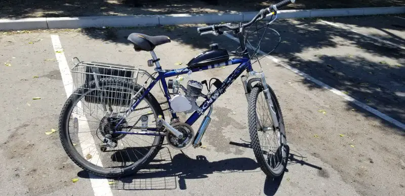

Thanks for the info.much appreciated. Im not into it for the speed ,I injoy just cursing down canal banks and bike paths by the river.At 63 don't need a spill.
I also injoyed building them. I built a few recumbents from donor bikes ,but this is much more rewarding .thanks again.

Great looking bike Lorenzo & one that states cruiser not racer. There are a lot of us older guys on the forum that are starting to acknowledge our maturity. but occasionally still feel a need for a bit of speed, lol.
I really like the recumbents, but find getting down & up from them somewhat of a strain...might be the age.
