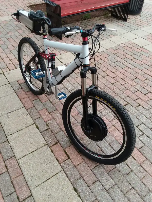

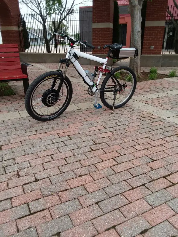

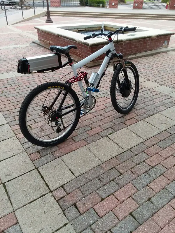

Parts came in and the electric mountain bike is a ride. I'll take a few photos today. It rides and performs great. The 2.4" Maxxis Holy Rollers were worth the money. Fine tuning the suspension today, really easy task with the air shocks, correct preload setup is about it on the street.
After the first fifty miles of operation I'm quite impressed with the lithium pack, not surprised, just impressed and it was also worth the money.

I proudly tooled out on my electric mountain bike yesterday and after a couple of blocks looked down to see if the new Holy Rollers were running true, when I noted the fork drop on the brake side looked a bit angled. I pedaled slowly back to the barn and removed the wheel and found I'd cracked the aluminum fork drop, almost certainly due to incorrect assembly/mounting of the motor hub to fork. I was one spacer shy of correct and aluminum isn't forgiving like steel, cracking before bending. A few hundred dollars mistake for sure my fault & thus the dumb, but still fortunate to have noticed something not quite right before a catastrophic failure occurred which would eventually have been a certainty and that's the lucky part, coupled with a lifetime of riding experience and habitually checking and questioning the bikes roadworthiness.
Fortunately I do have an almost new Rock Shox fork to replace it with....One step forward followed by two to the rear & I call that progress, coupled with a degree of necessary reconsideration!

I replaced the front fork on the Mountain e-bike and used a new RST suspension fork I'd forgotten I had on hand rather than the used Rock Shox. No real reason just did and it's preforming well initially. The real proof is how well it holds up in the coming year. I've not rebuilt any RST forks so I'm not familiar with parts availability etc., I'm an old hand with Rock Shox though....we'll see.

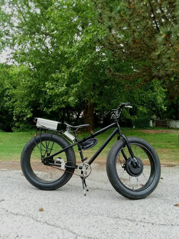

As advertised my two e-bike conversions are quite simple but are great to ride!

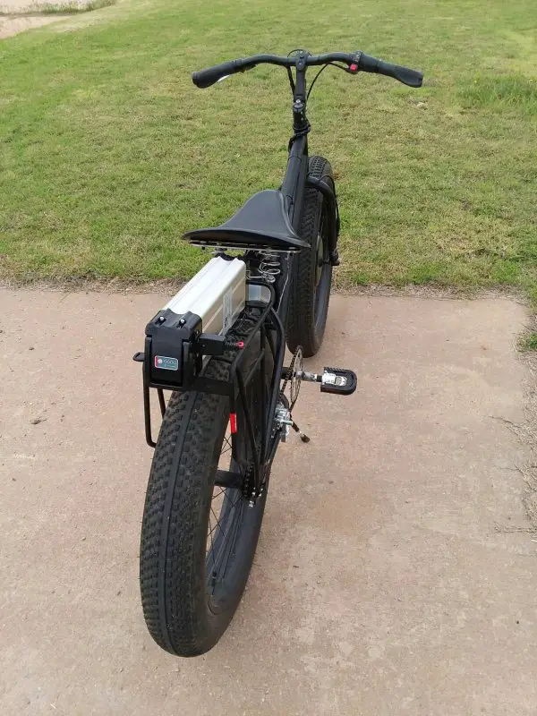

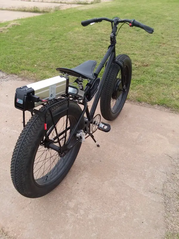

The fat tire bike has several not so obvious additions to make it easier for me to ride. the bobber style saddle is sprung and is mounted on a gas filled dropper post so I can adjust my ride/ saddle height on the fly which allows more power to the pedal levers the higher the seat position. The wide saddle is quite comfortable on rough roads especially, but this comes at a cost on long rides because the extra width of the saddle rubs the back of the thigh while pedal assisting. My remedy for this was to install wide pedal levers (bent) like we use to clear motor cases on I.C. builds. This mod requires a slight amount of bow legged pedaling which eliminates most of the pressure of seat on thigh. Though a road bike purist will no doubt point out the errors in maximizing power transmission, with good reasons, in this style; the e-assist more than offsets the loss of power in the stroke and extra strain on the legs. I also used folding pedals to reduce the extra stick out of the wide levers when the bike is on stand, which helps limit tripping over the pedals.
The handle bars are mounted on a "tool free" adjustable ahead stem; that doubles as a handlebar shock absorber with 3/4" of travel. This is a great accessory if one has hand, elbow or shoulder problems. I have all three & it's a wonderful help. I bought 3 of these, several years back, made by "Kind shock", but think they are no longer manufactured.
The rack is steel and well made with multiple attachment points, but definitely not a unit that will just bolt up out of the box some simple fab work is necessary, but this one is specific for 4" wide tires and no bending was necessary. The battery case design has a locking slide that is edge mounted and this required making an additional backing plate to bolt slide to rack...easy project. I'd prefer the li-on pack to lie flat rather than on edge & mounting in that position would be easy as well, while retaining the key lock function, but access to charging ports and controls wouldn't be easy to access. Also ports facing either up or down are entry points for moisture. Water resistant don't mean water proof. With time I'll adjust to the look of the battery case I suppose.
Other additions are the drive off stand and a pedal chain tensioner, I'm a fan of tensioners, especially the spring loaded ones.

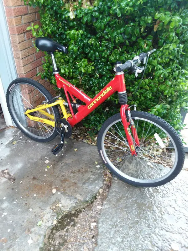

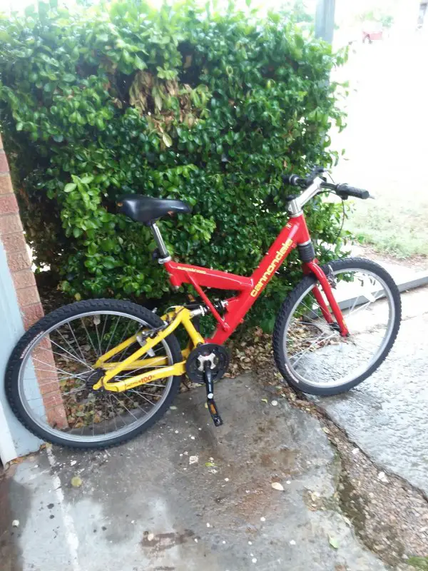

I stubbled over my Cannondale m.b. this a.m. and decided it would get the fixie e-bike conversion as well or go in storage...36 volt 500 watt more than likely rear hub motor this time and disc brakes front and rear. Full suspension bike in awesome condition, but v brake equipped & 25 years young.
