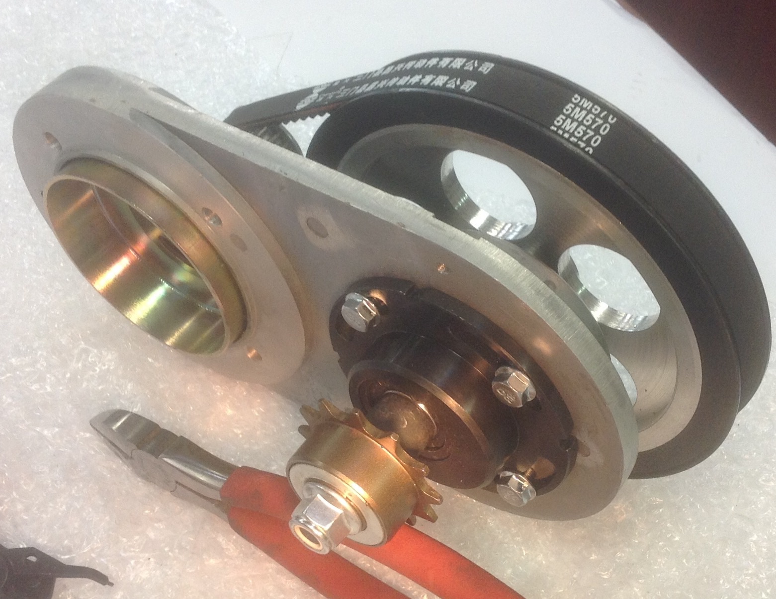

This is the way my 4G arrived today. In looking at the parts diagram this snap ring is suppose to be on inside the cam housing. I have another 4G on my bike and you can clearly see it inside the housing at the very end.
I figure I'm going to call the supplier to replace the unit unless it's not to much work to pull things apart and install it.
Any one pulled a 4G apart to know?

Wow the quality control is at its best over there! Sorry about your 4g ..it sticks when you wait and get something like that. Pretty easy fix.If you have a Harbor Freight they sell a sell of clip pliers with 3 different heads.Pick the one you need and when you dqueeeze them they will open up the clip
Opposite of noal pliers...good luck
The snap clip won't fit in even with clip pliers because there is no room and nothing will move. Does the whole cam assembly needs to be pulled to get the clip in.
This is the shaft assembly inside the cam assembly.
One of your bearings is not pressed all the way to the fatter center part, or the shaft assembly is not pressed in to the stop in the cam assembly where the pulley is.
Yes the whole assembly comes apart easy out the sprocket side if you have a bearing press.

Your bearing is just not pressed in far enough to get the clip on.
It is best to take the cam assembly out but to do it but you have to take the 100T off, and to do that you need to take the 20T as that pulley can slide off with the belt on it, the 100T can't.
This is a pain in the butt but you might be able to fix it in place.
Take the sprocket off.
Brace the base (not the pulley) and with a piece of wood on the end of the shaft give a couple good whacks to make sure the pulley side bearing is seat against the cam assembly.
If the sprocket side bearing didn't follow in...
Get a washer or heavy chunk of steel as wide or wider than the bearing with a hole for the shaft to go though.
With a long socket for even pressure you can press (or hammer) the bearing the rest of the way in and clip it.
You need to press BOTH edges of the bearing, not just the inside or outside or you'll compromise the bearing.
DO NOT use the pulley as leverage, hold just the base as that pulley can bend pretty easy!
Think I fixed it? I gave a good tapped on the output sprocket nut against the anvil and the shaft moved enough to expose the slot for the snap clip so I took off to Harbor Freight and pick up some snap pliers and got the clip installed.
