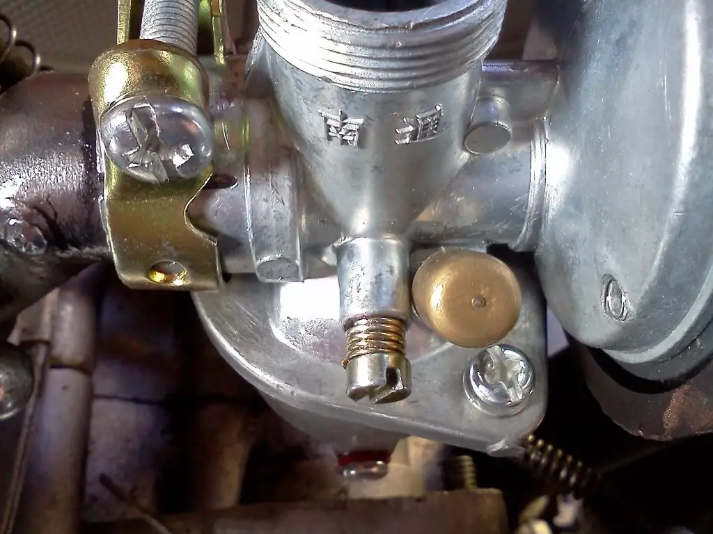

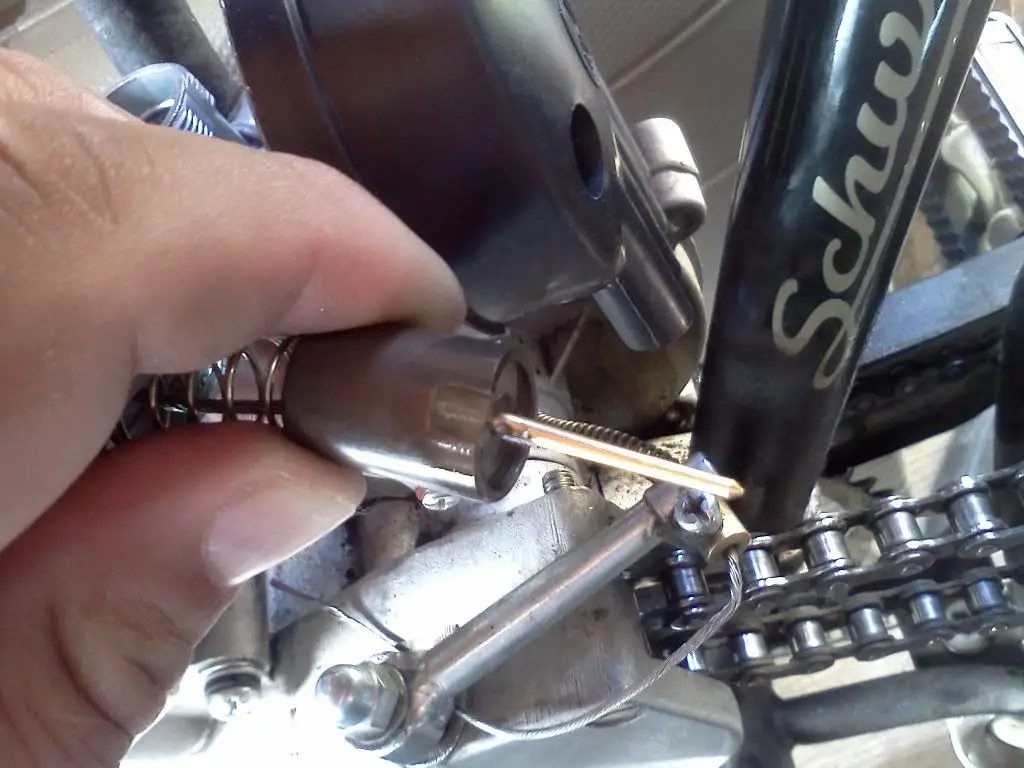

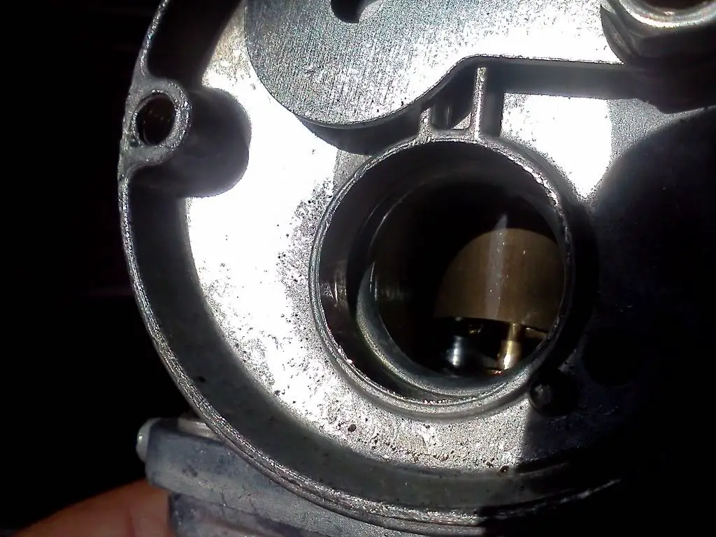

Im having the same issue with the new carb. I even replaced the main jet with a #66 I had to try getting more flow. The screw is in as far as the spring will allow, the slide is up quite a bit, and it still idles so low it actually died when I came to a stop sign yesterday. Here's some pics to show you what I'm talking about.
The first pic is with the screw tightened with the spring still on, not far enough to hit the needle.
I have built 2 other 66cc's with nt carbs and didn't have an issue like this. Any ideas?

the idle screw should never contact the needle. it pushes against an angled groove on the slide which raises it.
with the idle screw out, the slide on the NT should sit all the way down in the carb, covering the throat. when the screw is turned in, it'll slightly raise it up until you find the right setting.
if you screw the idle all the way in (don't foce it, just till it stops,) the factory setting is 3.5 full turns out.
from your pictures, it looks like your slide isn't going all the way down.
if the slide is raised like that and it won't idle, i'd definitely look for an airleak. it should be revving super-high otherwise.

The slide works fine, the pics are just to illustrate how far up the slide is just to keep it running. Lower than that and the thing dies.
