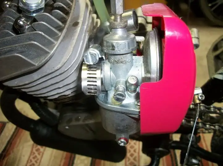

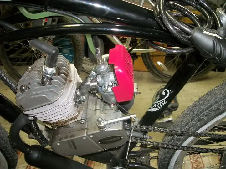

After having my carb blow off three times i decided to chunk that stock clamp and get something better everything here has already been said but i added pics for anyone that may need them.

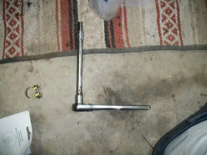

supplies you'll need;
1. sandpaper
2. silicone
3. 3/4 to 1 1/4 inch hose clamp
4. O ring (optional and found at sick bike parts)
Silicone (hi temp is best but i had this on the shelf)
Hose clamps (found at advance auto 2.35)

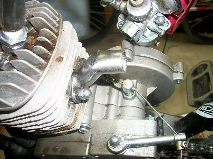

first step, clean and sand intake (put paper towel in intake to keep grit out of the engine remove when finish sanding)

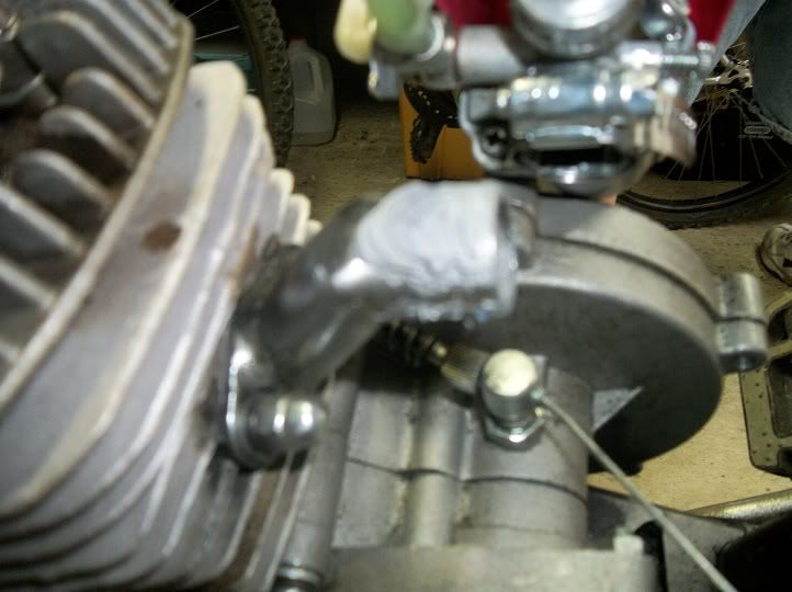

Next smear some silicone on intake (make sure none gets on end in intake)
