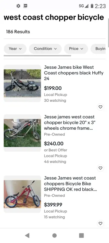

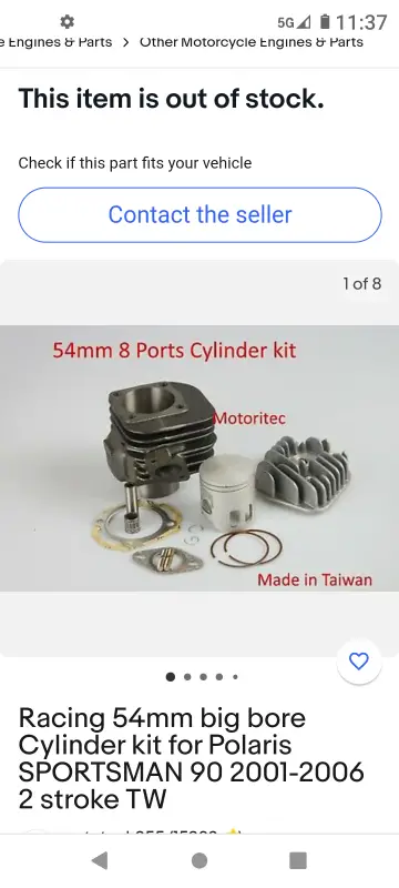

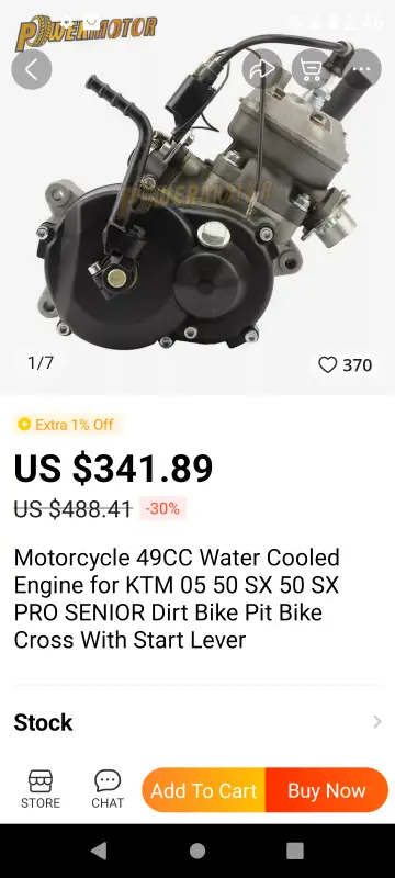

I'm in the same boat with this project... 110 case reed with a Polaris 90 top end I've got parts for but I'm going to do a few simple builds first to build up to it... I'll encourage you with links to parts and ideas.. if I was going to do a chopper I would start with a Jesse James 20" bike with a 24" on the front... Very strong frame... moped forks KTM sx65 motor... You mount the 420 sprocket with concrete testing pucs 70duro cut up like a rag joint with a 44 tooth sprocket as the washer a piece of PVC lumber made to fit the convex of the spokes as a spacer... All it will want to do is wheelie and burnouts... Hit it with a holographic wrap for cars... Get someone who does tint to do it up in 10minutes... Disc brake caliper paint is going to be your best friend... The 2 part paint has a short shelf life and once it's mixed it's got to be shot... YouTube how to do it and have

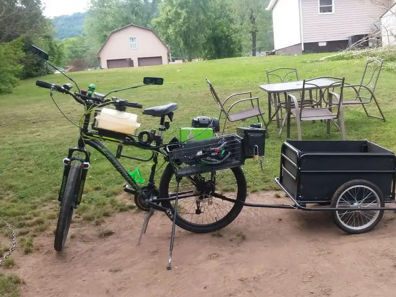

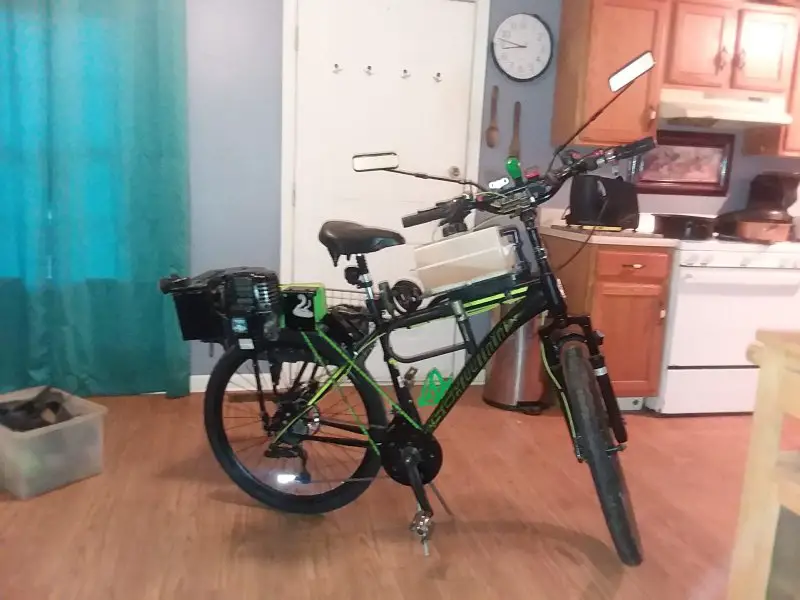

Unique is what I'm all about, my first bike the LandRider shifted 7 gears automatically. My current bike the Sidewinder has a triple chainring shift kit. Giving it a reduction range of 66.79\1 to 16.25\1.

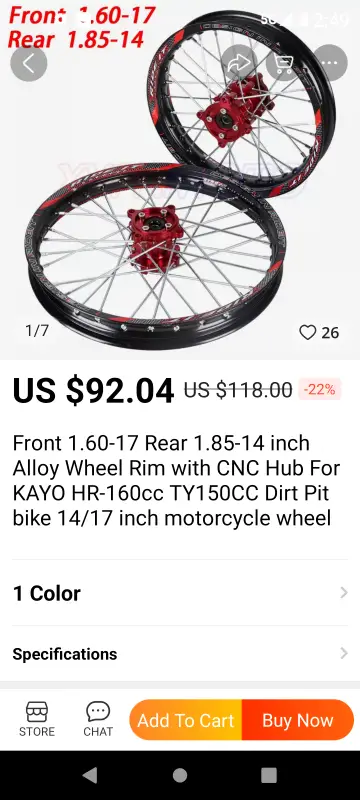

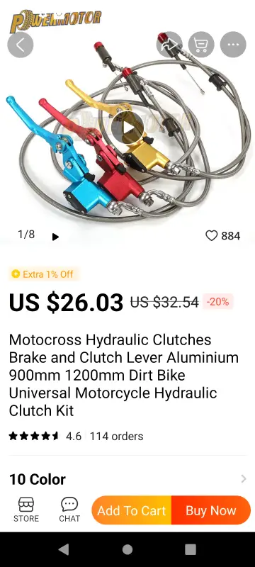

The hydraulic clutch setup for the rear brakes... Pit bike on a bicycle frame...
