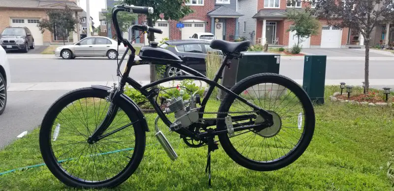

I am new to building bikes. I have two motors and 2 beach cruiser bikes. I am almost finished building, but came into chain tension and alignment issues.

Welcome to the forum, there's a lot to cover when putting together a bike kit, chain alignment problems are a common problem. If using the kit supplied rag joint I like to mount it to the wheel and put the wheel bake on the bike and spin the wheel to adjust the mounting bolts till I get the sprocket running true. You can mount the sprocket dish in or out depending on what you need or for frame clearance.

The issue that I have; is when I ride the bike - it feels like every part on the bike and motor is about to explode into a million parts. I know they are rough running and "shakey". Even with good thread lock, bolts are loosening etc.
