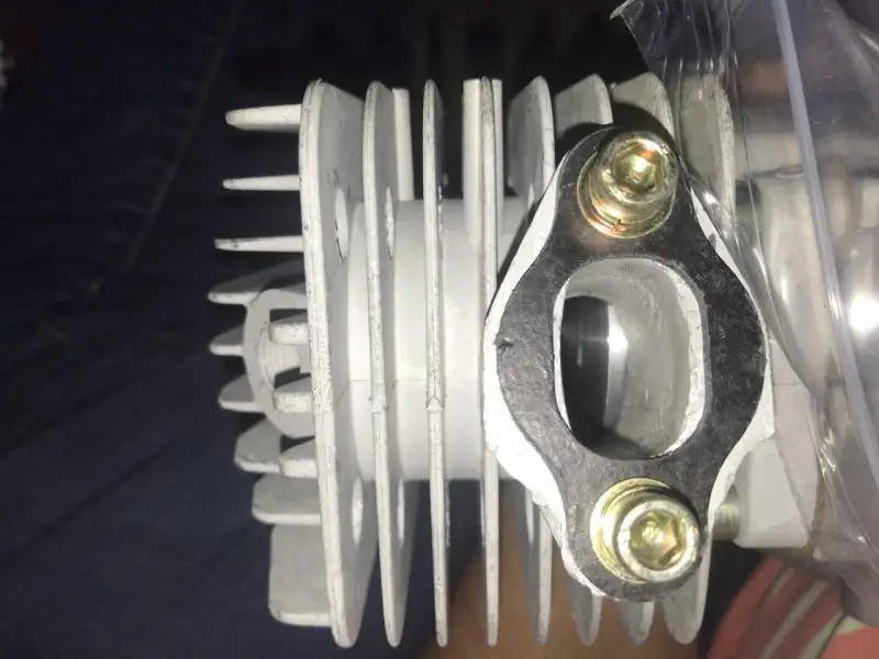

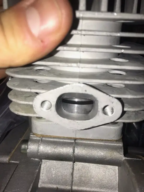

I received this 66cc engine off of amazon from the same seller as my last engine and first off you'll notice there are no header/jug bolts. The head and the jug are one piece with 4 hex heads at the bottom of the jug to connect to the lower part of the motor. Has anyone else seen this style engine before?
Also the ports seem pretty clean and smooth, not perfect.

That is like most chain saws and string trimmers are designed today, one advantage is no head gasket to leak. I wouldn't do much till I ran it other than cleaning up the rough spots if there are any. The disadvantage is if the squish band is not correct you are stuck with it, you can't upgrade to a after market head to improve Cooling and compression either.

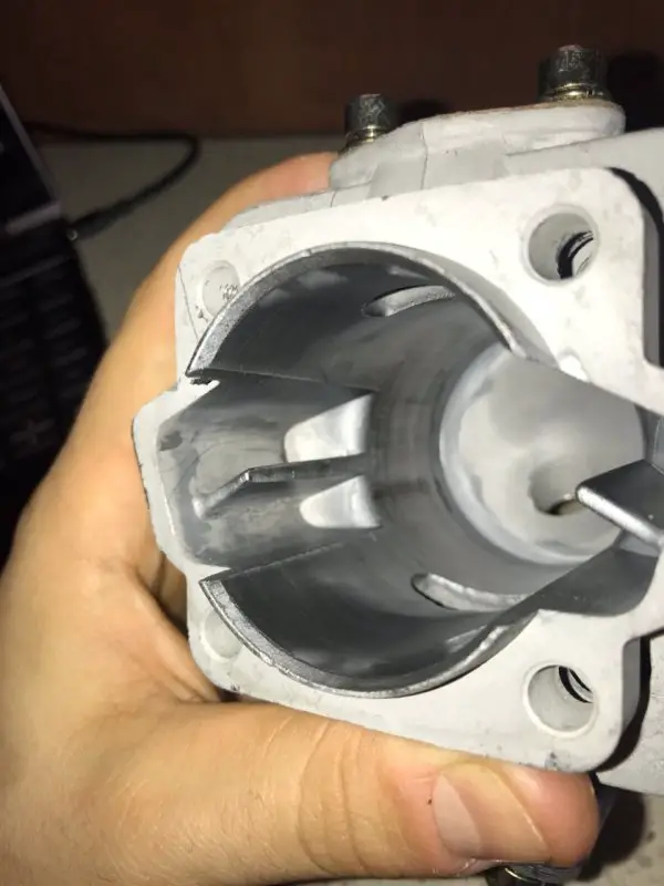

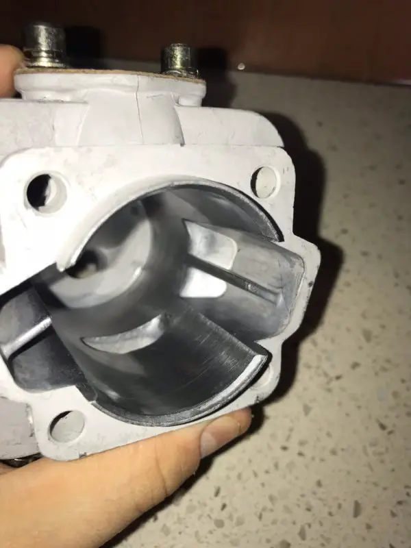

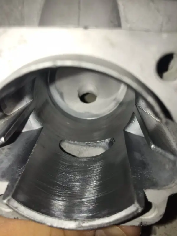

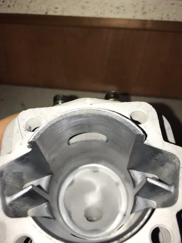

I decided to take off the jug(if I am using incorrect terminology please tell me) look inside.
What I believe I should do is bevel the edges of the intake and exhaust ports.
Also what are those ridges in the middle of the transfer ports??
Can I remove them to allow better flow?
Be careful not to get into the cylinder with the rasp, don’t remove the dividers in the transfer ports, they keep the rings from hanging at the top of the port. Without the divider the width may be too large.
That cylinder looks pretty good I wouldn't spend a lot of time, you probably won't notice much gain.
