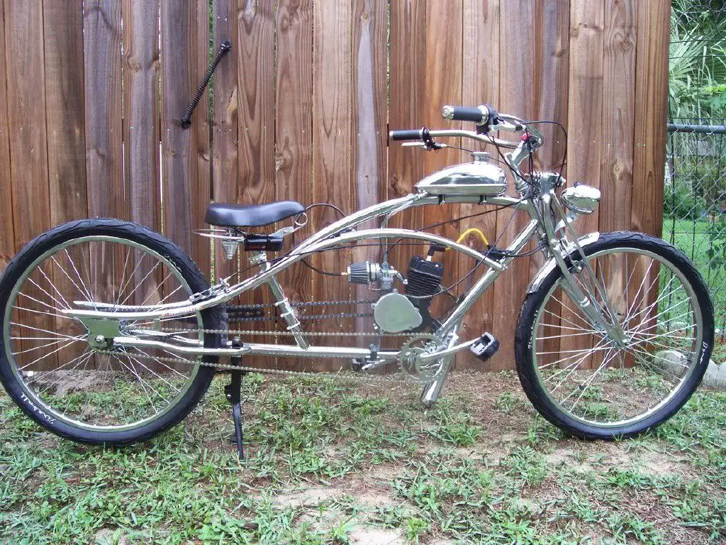

I had to retire the red frame. It developed a hairline crack after about 1100 miles. I may be able to fix it. I transferred all the parts onto a chrome frame and added a chrome tank.

The connection into the air cleaner is Nitrous. I connected the air cleaner by mounting 2 large (same circumfrance as carb) washers onto the carb and then mounted the rubber fitting from air cleaner over them. Tightened down with existing clamp.

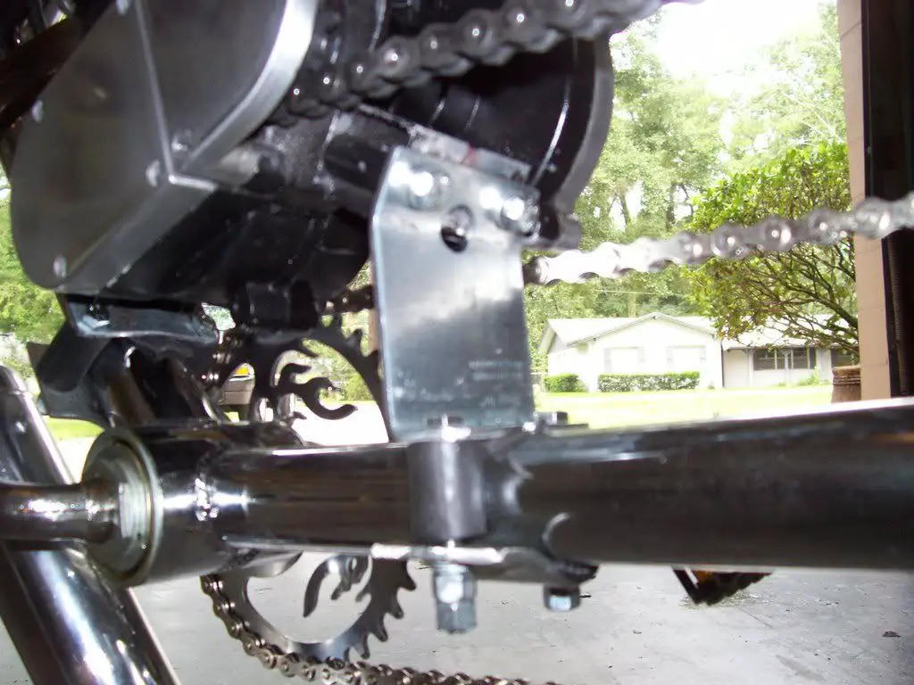

These mounts were made from a Simpson construction tie and a chain tensioner bracket, I cut the lagre part of the tensioner to match the small part. The width worked out to go around the large tubes. I used rubber fuel line to cover the bolts bewtween the sections.[/IMG]"]

Just curious, where did the old frame crack ? Do you think this was the result of a bad weld or was it due to stressing the frame by mounting the motor on it (vibration etc) ? I'm curious to see if the new frame holds up. These stretched cruisers are indeed a sight to behold and I'd love to build one.....I just can't help but wonder if beefing up the frame a bit might be in order ? Your thoughts please ??

This is a heavy bike!! So my thoughts are that the gauge of metal used to construct it is sufficient. I had over a 1000 miles on the red frame and when I say crack in it....it is as though the weld just came apart. I can clearly see that the weld did not penetrate the two pieces bieng welded. I will keep you posted on this frame.
