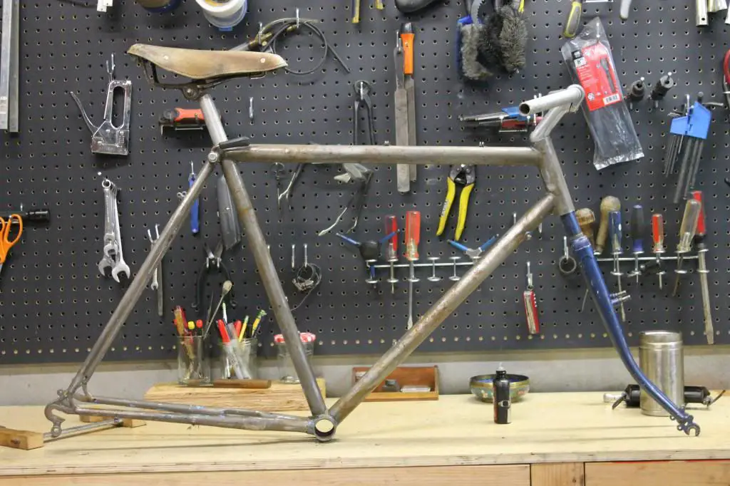

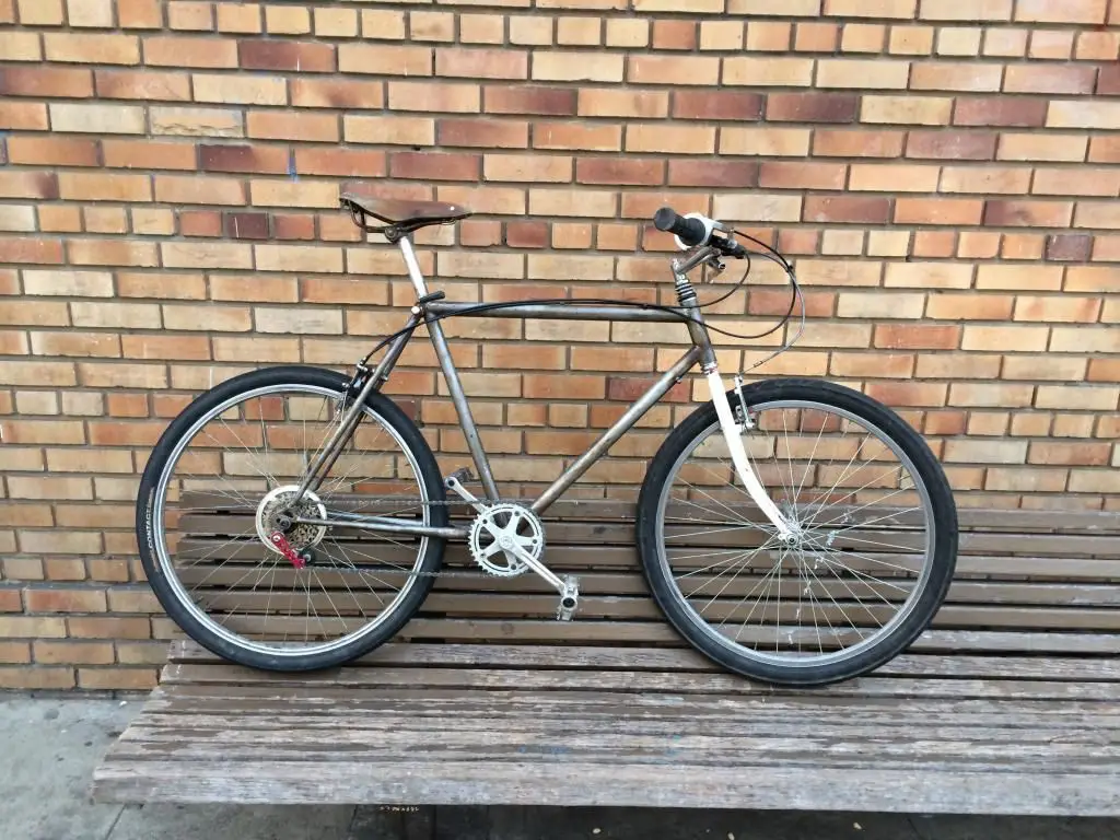

This is a frame I picked up a while back and have been really wanting to build it ever since. Ive been slowly gathering parts. Too much schoolwork right now to do any building which is frustrating, but after thanksgiving I get easier classes. Anyway - its a "sterling" frame, it would appear crappy at first sight because of the lack of brake bosses, but its from the very early days of mountain biking where caliper brakes were common. Its really heavy gauge tubing, and the head tube is this weird BMX size from the 70s and 80s. Its not 1/18 but oversized 1".

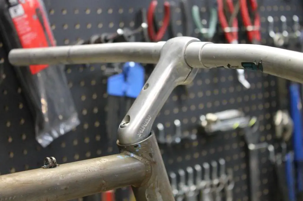

Its got really pretty welds and Im using some cool old schwinn forks, aria rims and hopefully some big old motorcycle levers. Also have this nice specialized quill stem and my favorite handlebars.

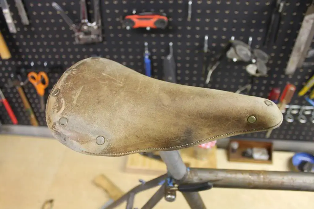

The seat came of a cool road bike somebody was tossing in my neighborhood. I think it looks really cool on this bike.

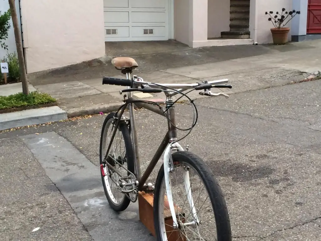

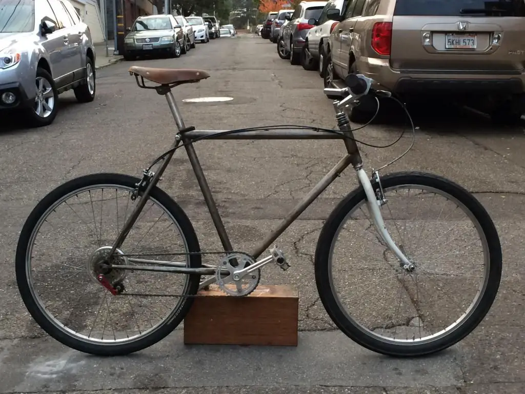

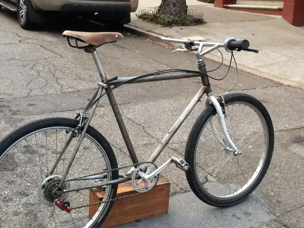

Here she is: (about 10 pounds as she sits above - heavy duty)

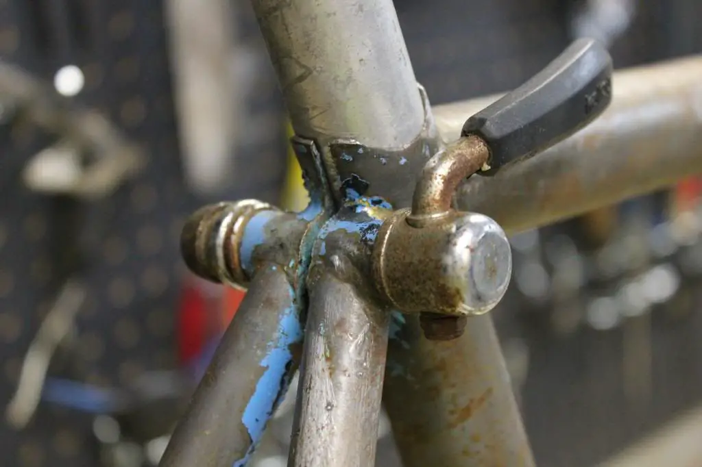

cool seat binder built into chain stays:
seat needs some snow seal but shows no cracks and is comfy

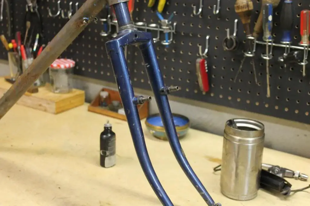

forks:

Somebody threw out a roadie with a leather saddle! What an idiot. Sounds a lot like my 1950s English 'Wearwell' pathracer, - that was tossed in a skip by someone who didn't know what it was.

got this bike together today
headset was a pain in the ass to install
I am using:
vintage bull moose handlebars and some nice old xt brake levers
shorty 165mm cranks for ground clearance
nice metal throttle
single speed chain tensioner
I think it looks really good
this frame has ridiculously relaxed geometry which means its comfortable but doesn't really corner fast. Still I really like the way it rides. pics
