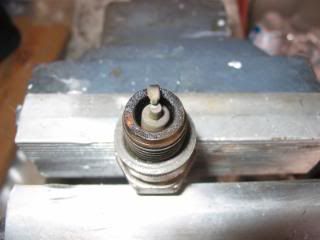

cvlt1 hey Norman heres a pic of my spark plug..check it out

so right now the plug is brown

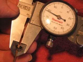

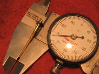

Your plug is still rich more black than brown look at the center porcelain that is where you need to look I have a picture and some of the needle. You might get a better idea of what they should look like.
picture of my plug its been idling but you can see the center is Grey and dry. The grey probably due to the oil in my mixture using Castor and a syn. oil other wise it would be a more tan or brown could be its a little lean but it runs cool (350 degree's on the head) good power all the way from idle to wide open.
top needle measured about 0.078 this in the idling circuit part of the needle
this is at the tip of the needle around 0.067 to 0.068. controls 3/4 throttle . Wide open will be controlled by the main jet I think mine is 0.026or 0.027"
does this help?
Norman
i can understand now the difference in width, but how can the top of the needl control anything? i mean how does the thicker top control the iddle?
i thought the needle went down to the little arm that holds the float in the carby. and by placing the clip up or down you control the preassure on the float. so the needle doestn really control the air, it controls how much gas the carb will mix with air...obviously more gas means less air, and less gas means more air to some extent.
now im a bit lost on how can the thicknes of the needle affect both iddle and accel.
