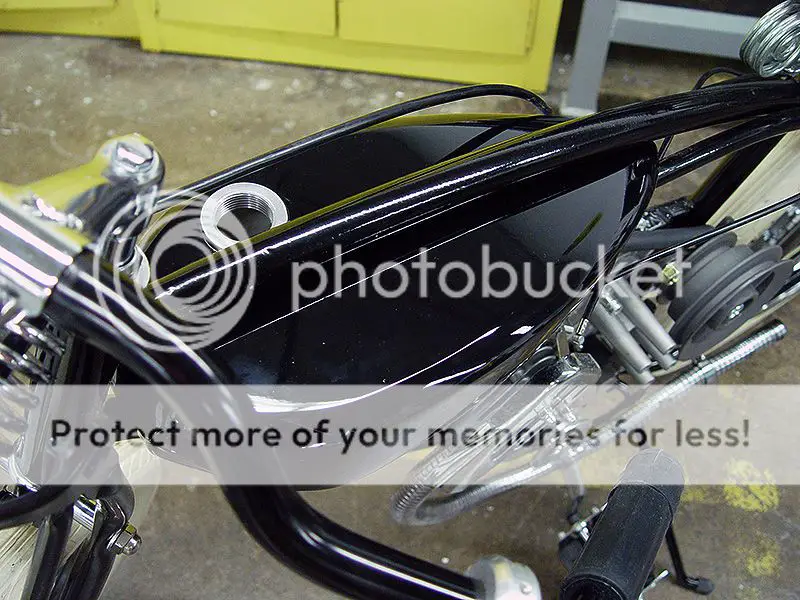

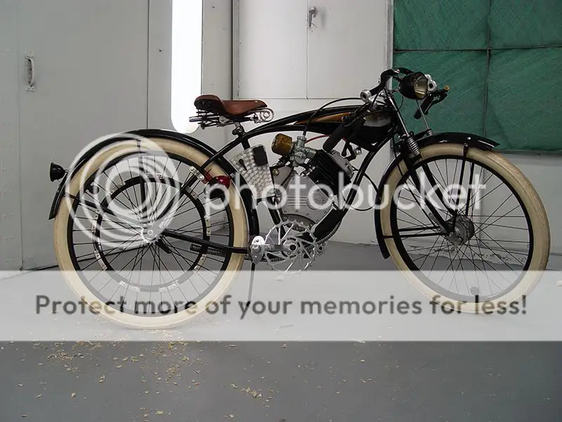

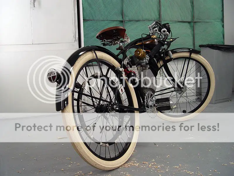

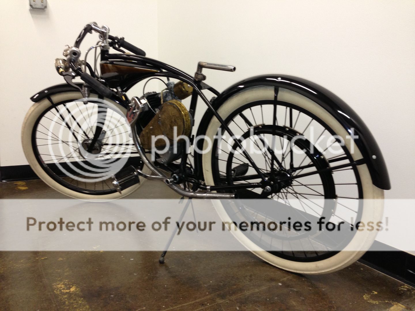

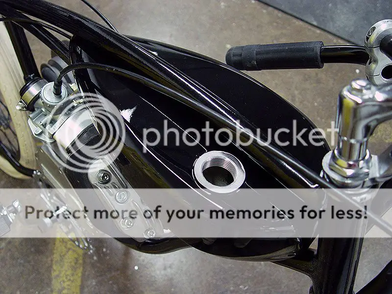

Here's one I'm finishing up on a '49 Phantom frame. 2012 motor. I handmade the gas tank, because I think those peanut tanks sitting up high look terrible and cheezy.
The Schwinn frame has specially-fabricated, CNC plasma-cut mounts that I TIGged to the Schwinn frame. There's a damascened aluminum panel that holds the electronics. Track bars, twin spring front end, drum brake on front, original '40s flex exhaust. The headlight and taillight are being replaced, so 2 weeks from now it'll look a bit different.
I've just finished reducing the wiring harness to basic magneto and ignition and will be soldering and looming it fairly soon. The lighting will run from a vintage sidewall generator...still have to get out the striping brush, too. I had hoped to have it on the road this summer, but too many projects ;-/

Nice looking build and I agree that your in frame gas tank is much better looking than the peanut type of tank.

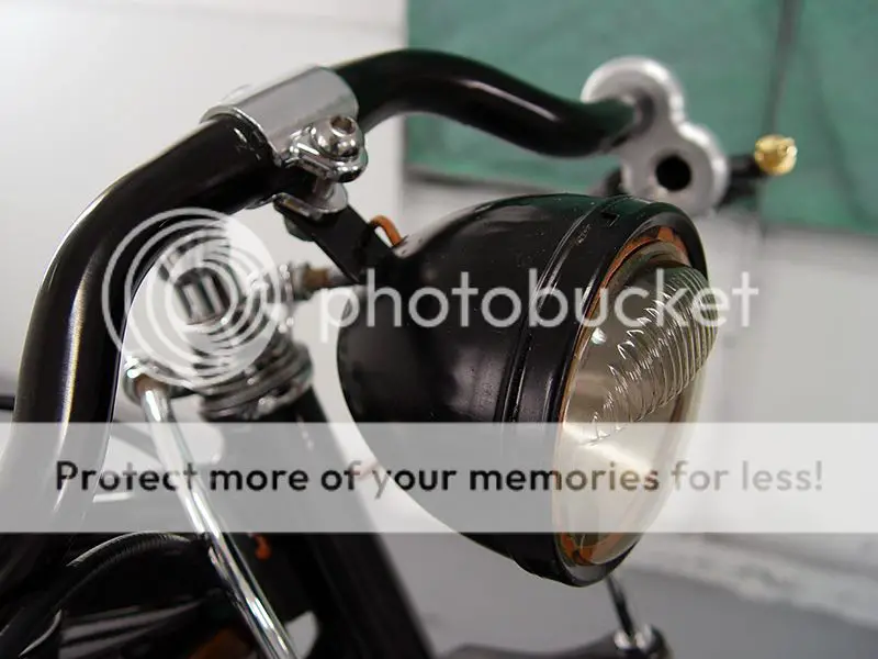

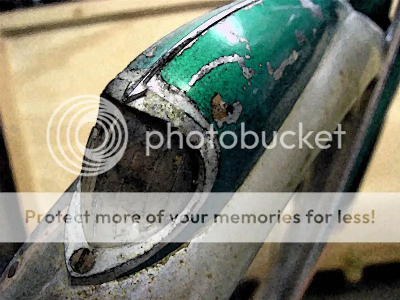

Here's a photoshopped close-up of my Green Phantom's headlight, showing what is probably the only non-original screw on the whole bike.
I rode it today, and it is a Cadillac despite its run-down condition. It's 100% complete, a barn find and very sound. I forgot how wonderfully these ride compared to my stable of Italian steel lightweights. Whatta smooth experience...

I agree with the thoughts about the peanut tank, I have been trying to come up with ways to put a gas tank inside of a horn tank and making some type of clamp and hinge system to open the one side and reveal a filler hole. I would still have a horn button in the tank and have an externall horn mounted on the front fender.

The main issue with putting a gas tank in the horn tank's space in a cantilever frame is volume. The sculpted tank that I designed and fabricated is a full 2 1/2" wider than a stock frame horn tank, yet I am doubtful that it has the same capacity as even a tacky peanut tank. To use a stock horn tank as the outer shell, keep the horn button and still have decent fuel capacity is a big order...

As far as the gas tank built into the horn tank I figure I could have it hold between 1/2 and 3/4 a gallon and if I am getting around 100 mpg's That's a good 50-75 mile ride which if topped out at 30mph is nearly a 2-3 hour ride before filling up. For me that's about all the time I would get. Once the kids are older and I can get more time to ride I might look into a better option or just add a T and a rear tank for longer rides. .we.

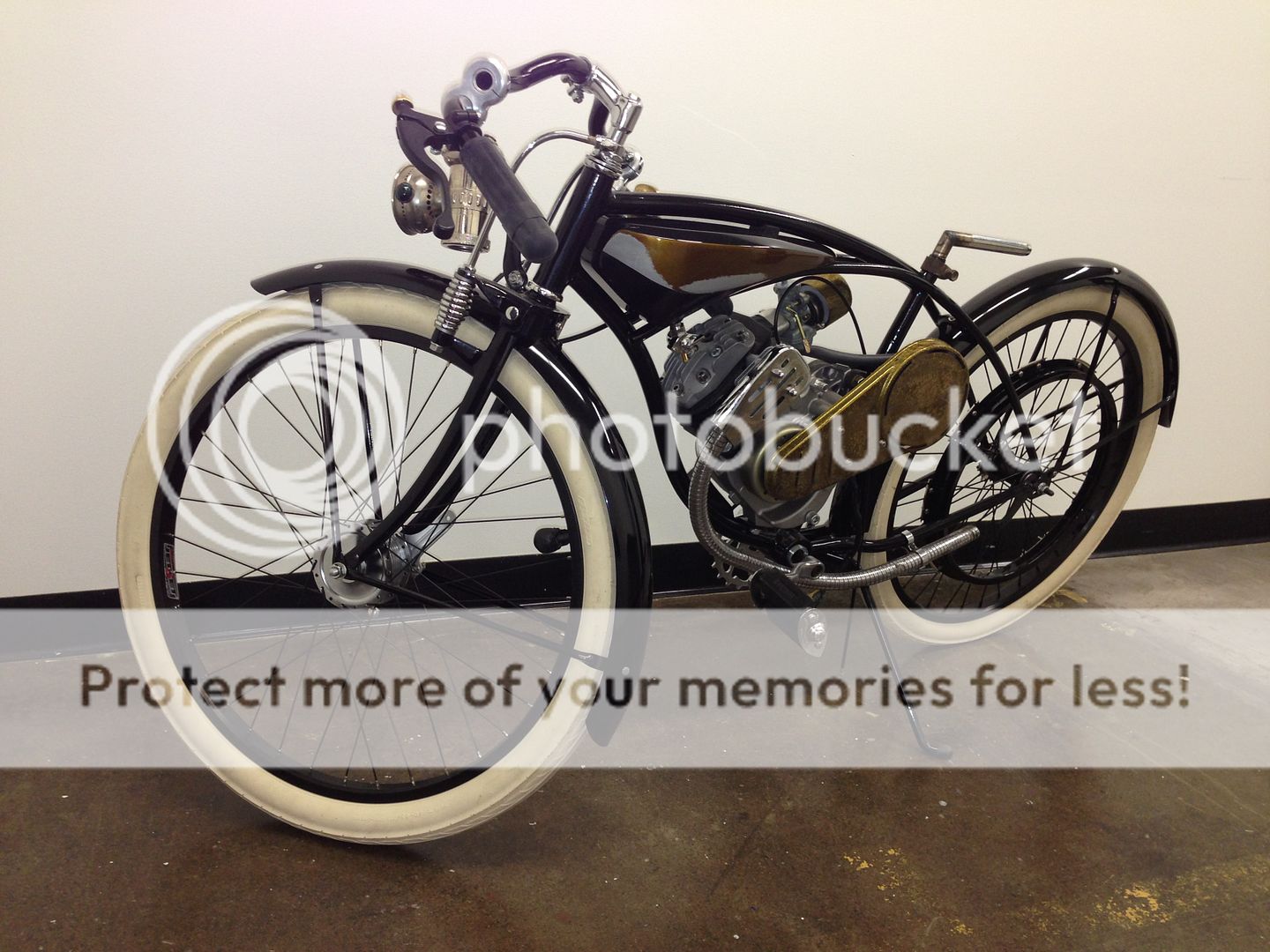

Just installed the 1945 generator set that I got on Ebay, NOS, still in original boxes. I think it's got the look I was hankerin' after.
As soon as I'm done wiring and cabling (yeah, I know I've got the front wheel flipped... figgered that out when I was cabling the drum brake!); I'm waiting for the clutch cable, as the Whizzer one is too short for my bars), off come the parts that haven't been powder-coated yet, and off they go for more gloss black...
You can see the damascened electrical panel with the kill/ignition switch in these shots. I'd say it's 95% finished at this stage.

No problem rickenbiker, just some inspirational photos. I really like the light set, the glass on that head light is something completely different from what I've seen before. Like an eyebrow. Do you know who it is made by?
