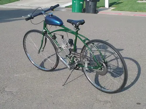

So today my engine kit unexpectedly showed up at my front door :o no complaints though. Can't wait to put it together! :D

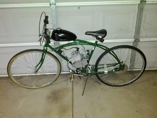

So to update. The kit is almost complete. I've been pretty busy so I haven't been able to spend a majority of my time working on the bike. everything is on the bike, just need to find the best way to tuck the throttle and clutch lines. And I need to get another retainer screw to lock the clutch line to the clutch arm because the one supplied cross threaded when I went to lock the line to the arm :( Also went to kragens yesterday and got a gas can, fuel filter, oil, clamps, and loctite. So today I'm hoping to everything finished. Pic will soon follow :)
So lastnight I started her up for the first time. I only rode around for about three minutes until I had to stop.

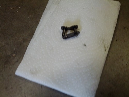

And this is why I had to stop lol.
I'm not entirely sure why the master link bent. Maybe you guys could help me with that? I felt like I had enough tension on the chain (chain could move up and down about an inch). And the chain lined up with the sprocket pretty well. I did however notice the motor sat over to the left side a little more then the right (like \ but not so drastic), could that be the issue? Since the only link I lost was the master link I'm going to get some more and try again and possibly pin point the reason why the link bent and came apart. Triail and Error :D

The master link gave out because it's china metal.
...just the way things are... some last, some won't
