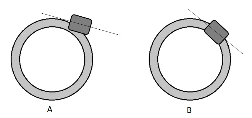

Sorry for taking so long to reply. The wheel in the picture is a standard Disc freewheel. The bike is being driven by the pedal chain on the right side. I fully understand the adjustments with the washers on the caliper, this is not the problem. If you look at the second picture you can see how the caliper is suppose to be sitting in order for the disc to enter it at the correct angle. This angle is not possible with the current frame mount. I will have to have a totally new mount machined to get the correct caliper angle. I started mocking up a mount a few weeks ago that would put the caliper in front part of the disc in between the frame. I have just too many other things going on to finish it at the moment.
Just bend your GT-150 frame disc mount, I had to do that.
The left and right alignment is not the problem. It is the angle the disc enters the caliper. Here is a quick image to try to explain. Letter 'A' is showing the disc entering the caliper as is. letter 'B' is showing how it is supposed to enter the caliper. There is simply no way to get 'B' without a new mount being machined.
You just need a different shaped mounting piece between the bike and actual caliper, and there hundreds of combinations pre-made and you can modify what you have too.
Do you have a local small bike shop nearby?
I live 1/4 mile from one and they are great guys.
They probably have one laying around that would work, take you bike in to see what they think.
