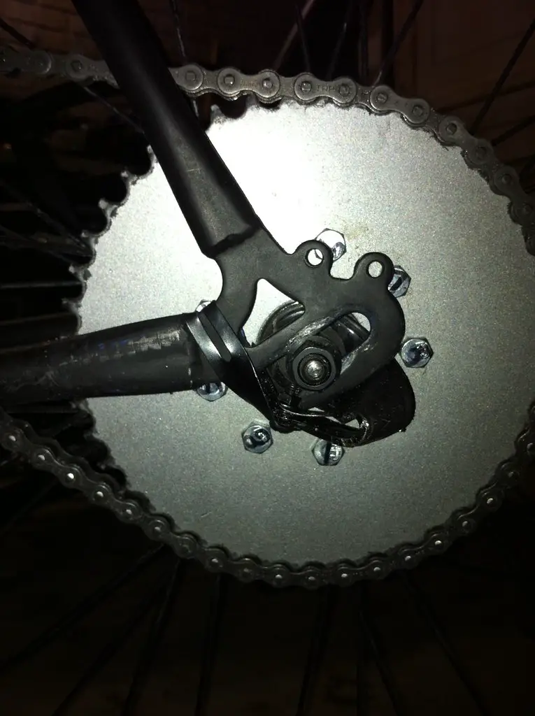

i startd on my build and my first problem was getting the rear sprocket on the wheel the coaster break arm is really on the way but i can see on your pictures that your coaster break is still there and you were able to fit it right. maybe i should upload some pictures since my sprocket looks different from yours. could you take a picture showing how your rear sprocket is mounted. thank you

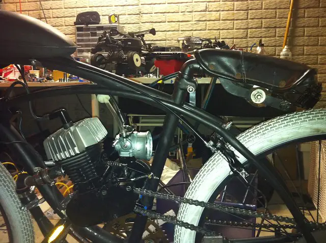

A few updates to the build. I added the RT carb/velocity stack/Puch Hi Hi Compression head/springer seat from a free Craigslist find. The seat really helps the build a lot!

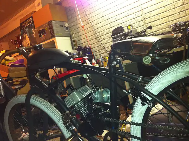

hey guys heres a picture of my finished bike i just have to make it a little more pretty thats all but she rides real nice. just wanted to update you guys on how it all went.
Great looking bike! Very clean, which is exactly what I'm after. I'm ordering a Cranny and motor kit on Friday. Did you have to use any special mounts to get it on the bike, or did the ones with the kit work out for ya?
Are those stock bars just flipped? If so, that's great!
Keep up the great work!
Thanks! My kit came with the large mount and worked fine. Those are stock bars cut 2.5", flipped and angled down. Just barely enough straight to get everything mounted to them.
