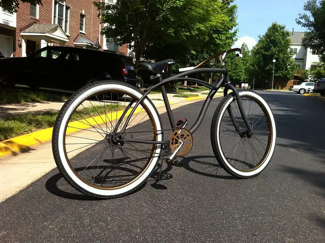

    So for my first venture into the MB world, thought it would be best to start with a Cranbrooke frame.
    Here's where I started:

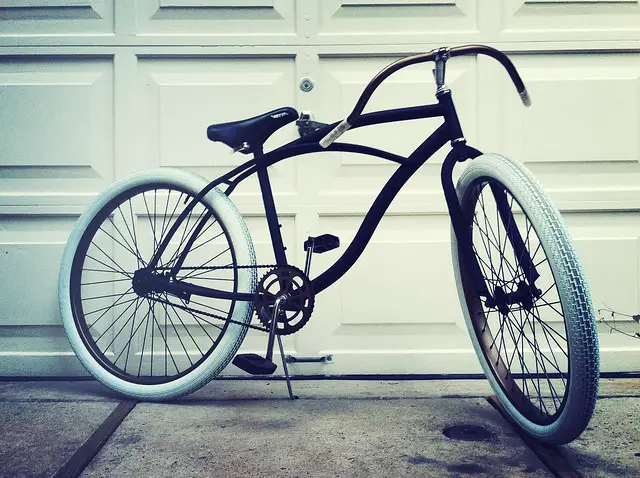

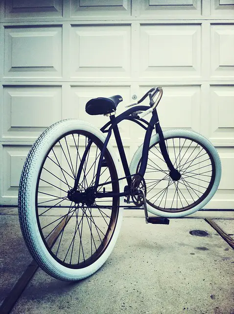

    [​IMG]
    Here's where I'm at:
    [​IMG]
    [​IMG]
    [​IMG]
    [​IMG]
    (Missed a spot on the fork! Need more light in garage for painting! Easy fix with flat black)
    I almost like it too much to add the motor! Love the super stream-lined look of no cables and the leather wrap for grips! But a screaming 2 stroker is just gonna be awesome on it!

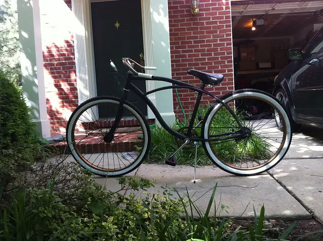

    As she sits waiting for kit and expansion pipe:
    [​IMG]
    [​IMG]
    [​IMG]

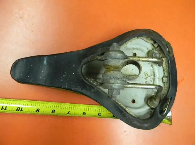

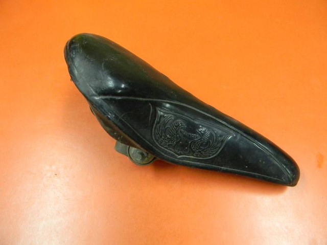

    Scored a Mesinger seat on ebay as well. Rigid but will look great with the build!

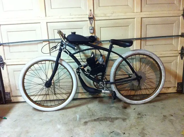

    It's up an running! Still need to adjust the clutch. When pulled it isn't disengaging all the way which you can here in the little vid I did. First ride and I lost the tensioner wheel which caused some slight rubbing on the rear tire. Turned out to be a good thing as I then took the time to mill a skate wheel. SO MUCH SMOOTHER! I also have some tuning to do. Runs pretty good, though. Took it for a mile trip to a town center nearby. People had no idea what the heck the thing was! So good! Need to pick up a different helmet as well. The full face MX helmet just doesn't seem to fit the style of the bike! At least it's all black! Ha!
    The Puch head install is next. Tried to locate some M8 threaded rod yesterday to make up some new head bolts, but struck out. I have one stock acorn that's being a bit stubborn and doesn't want to come the bolt. So instead of risking a bad seal, I threw the stock back on.
    Regardless of the cursing, smashed fingers, cuts, burns, and head scratching, what a perfect way to set off the first day of summer! I don't want to get off the thing! It's just too much fun!

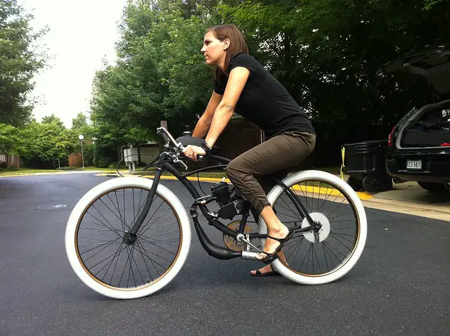

    [​IMG]
    [​IMG]

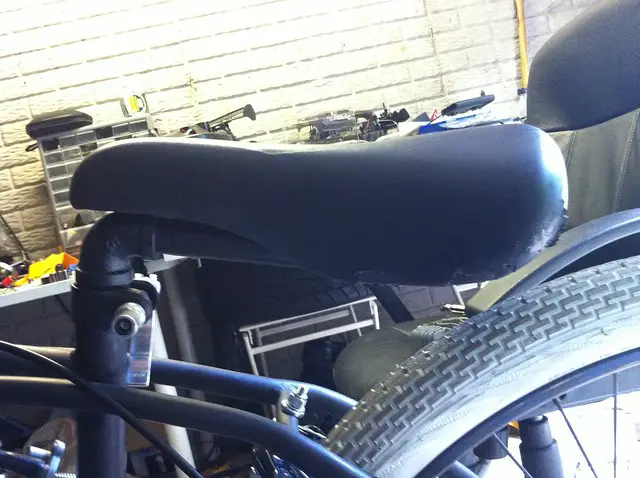

    timmiedisc-You hit the nail on the head with the seat post. I used a coupler from the electrical conduit section to thread on the bottom. It's a tight fit and I had to do some massaging of the seat tube and coupler for it to fit. I'll take some pics tonight.
    benutne-the seat laid back is actually a lot more comfortable for me. My legs are in a better position and a bit more stretched out vs being directly above. Sitting up all straight with big ol' bars and my arms spread 5ft wide just isn't my thing. Future plans even include triple tree forks and clip-ons. Then we'd be down nice and low!

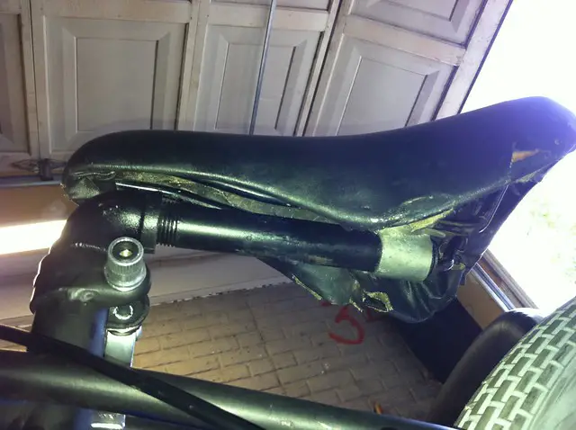

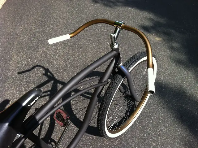

    Here's a few pics of the "darker, unseen" side of my bike. Should help give and idea as to how I made the post. Would love to show pics of the bottom part of the post, but it ain't coming out! I used a coupler from the electrical aisle of Home Depot that was added to the pipe from the plumbing section. If I get back there, I'll take pics of the parts used. But that should help everyone get on their way.
    [​IMG]
    [​IMG]
