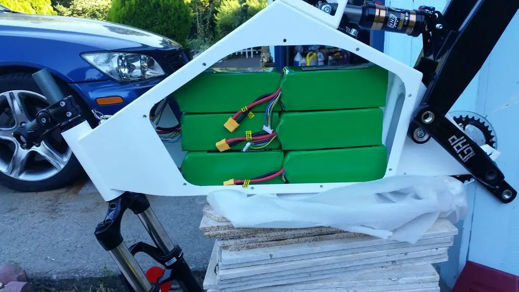

So it's been awhile, and I'm itching for a new build.
Frame is a quilbix raptor 140 frame. http://www.qulbix.com/
Front suspension is a roxshock xc32 tk solo air. Rear suspension is a DNM o2 aoy 36rc
MXUS 3000 hub motor laced to a 18" moped rim. Sabvoton sinewave controller, lipos 18s 32ah batteries.
Hopefully, everything is done before summer ends..

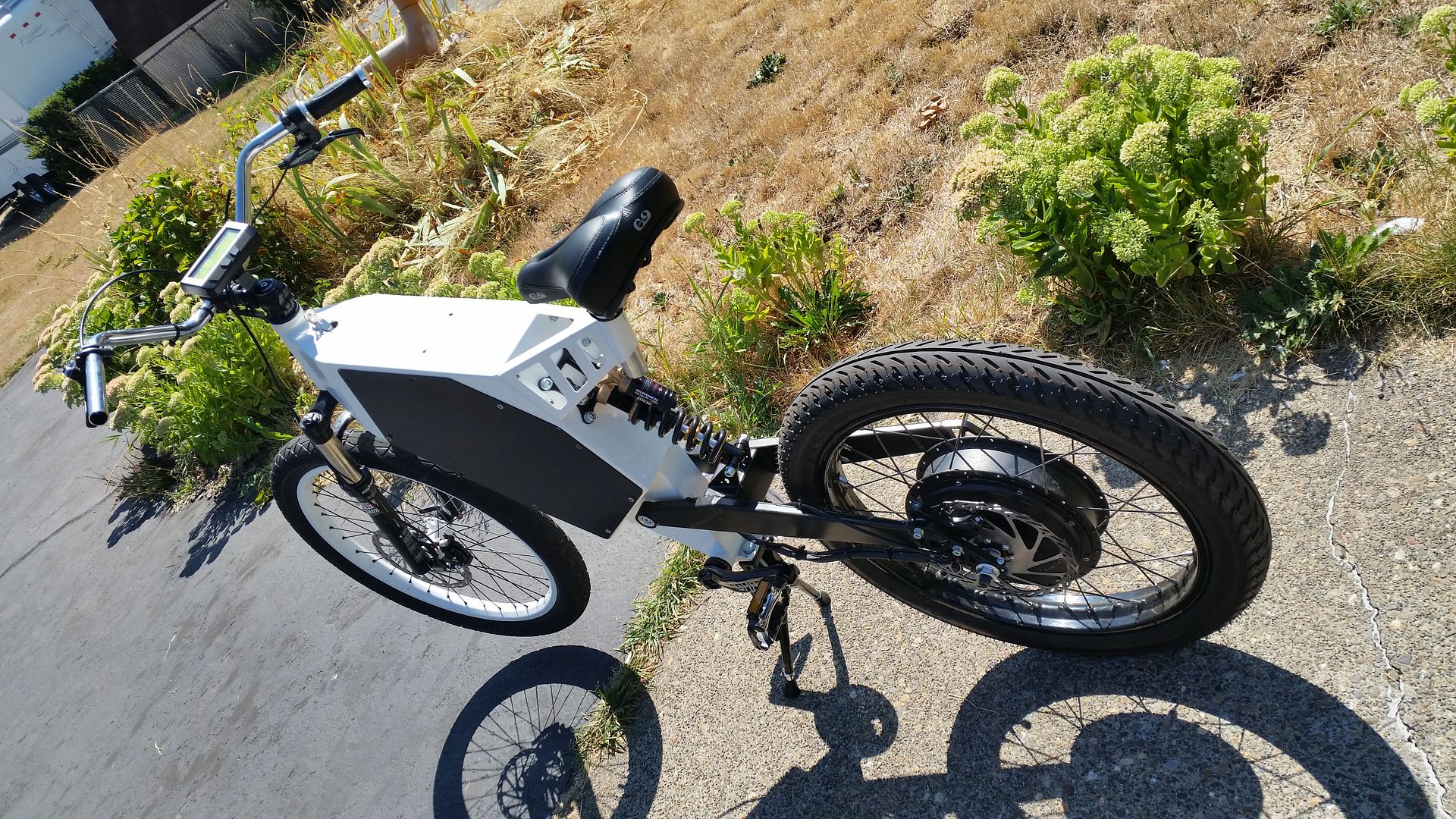

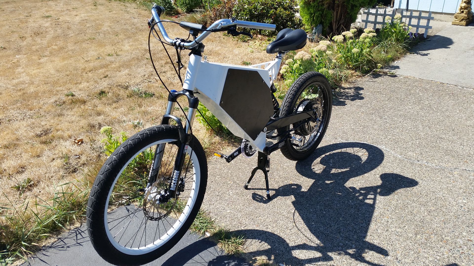

I finally found the correct phase/hall sequence on Mxus 3000 + lyen 18fet controller tonight. At first I got 49mph in reverse unloaded and it was as quiet as heck. I ran it for about a minute, and the motor, phase wires weren't even hot. Anyhow, I had to swapped a few more phase/hall combo and got about 49mph running forward. I went for a test drive, and the front end just lift off. Top speed were around 42mph and it get there quick. I need to flip the handle bar upside down for a forward leaning position to prevent the front end from lifting up. Or reprogram it to low amperage.
I ended up flying across the lawn on the second test run about 2ft up in the air..
Anyhow, acceleration was about on par to a 212cc build with a gear ration of 12. But feels alot lighter and handle quite well.

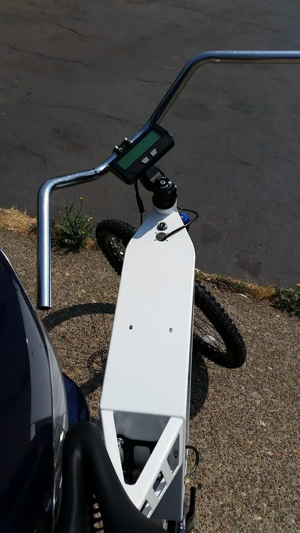

Add a set of straight or low rise bars and it will get your weight forward with out having to assume the racer position, unless that's what.
Sounds like a blast.
If that's a CA3 on your handle bars...you can set the throttle ramping slower so it wont do wheelies.
