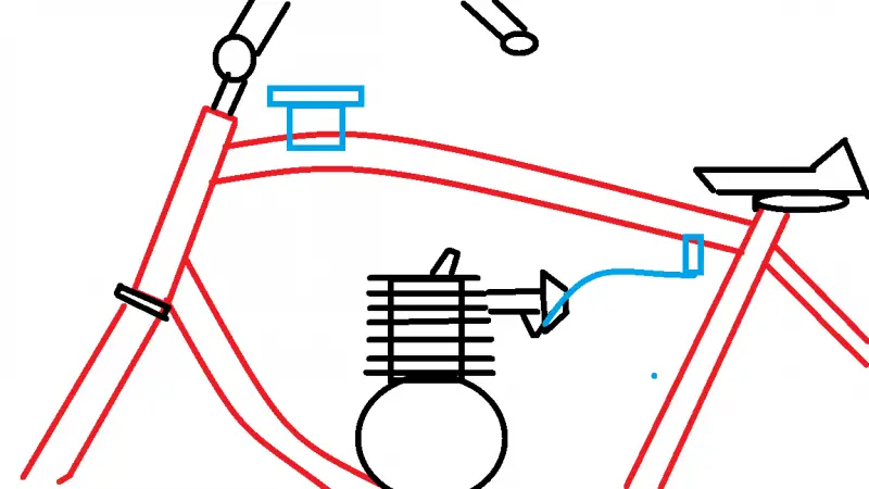

NOTE: On my Wish-List.... the top main bar on the Cranbrook Frame is sealed at both ends.... I'm eyeballing it as a place to store the gasoline by tapping the back of it by the seat post and welding/soldering
some sort of fuel neck up towards the handlebars. It would hold at least a pint and pretty stealthy... has anyone done something like this? I don't mind the china girl tank, but an in-frame would look so much cleaner, and I don't really need a ton of range. I could even widen the neck/reservoir for few precious ounces.

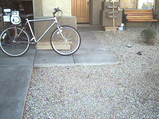

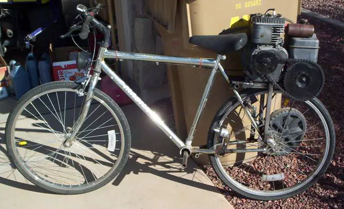

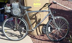

...in the meantime, here are photos showing I'm no stranger to Flathead Ugly Custom Shaky Builds! GOOD TIMES!
