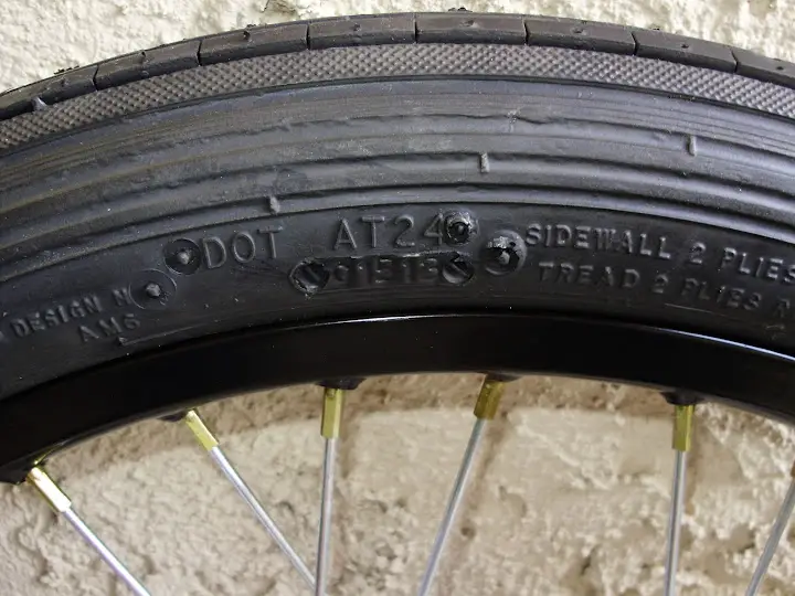

a bicycle frame is just that loading DOT approved wheels and tires along with engines that weigh above the little 66 cc cast aluminum China Doll is more a gamble than not it would be better to have a wheel fold under the bike's frame than the bike's frame fold under the seat

For looks, I can recommend the Felt Circuit tires. They are not DOT rated speed tires, but I have ridden them at 50mph and they seemed to work well. I also like the electra cruiser diamond tires in white.
But for handling, you can't beat the maxxis hookworms.
Hey Pat, I thought you have been using motorcycle tires on your builds? At what speeds do you run the hookworms?
Gilbert
I used to use the Hookworms on 200cc builds, then grew the bike into the Bonneville model which uses 21" motorcycle tires and rims. I still use the hookworms as standard on the smaller displacement bikes, so 79cc, 99cc and 160cc. The Quickbricks are just too thin with soft beads. The Circuit seems decent but not as good as the Hookworm. I have a set of Circuits on a 99cc four stroke build and like them as they handle well and do look pretty cool. I did just buy a set of these "Nola" Tires for a 200cc build. Have yet to try them out. They are heavier than a Hookworm.
