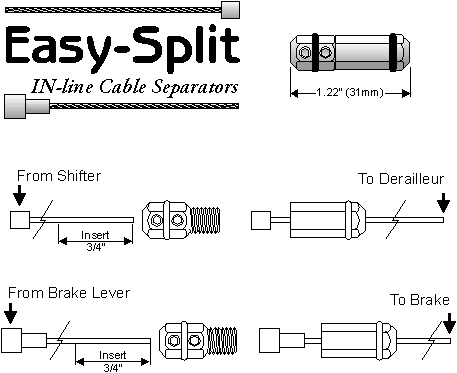

"I made a cable sheath coupler for the bike/trailer connection with a bolt and 4 nuts welded on it. Each cable end fits in the pair of nuts, and a mini cable clamp connects the two cables. It makes it so I can disconnect the trailer, and makes adjustment simple. I'm using a bicycle brake lever as a throttle, and it works well. "
Could you give a little more information please and a photo or two would be much appreciated. I've been trying to figure out a simple disconnect so that I can have a brake on my canoe sidecar, but be able to disconnect the sidecar easily. Your throttle setup sounds like the answer. So, I'm picturing the bolt with two nuts welded to one outside edge and the other pair of nuts welded to the other side of the bolt. Is that right? Many thanks...
SB
These are pretty pricey, but they may help you have an idea for shopping. Cable splitters for travel bikes that disassemble to fit in suitcases.
Cable splitters for S&S Coupled travel bikes
Thanks for the link. It has me thinking and later in the day will do some staring at a couple of dead multi speed bikes for hardware possibilities. The price is right on the bolt with 4 nuts version. The ones pictured are nice, but expensive.
SB
