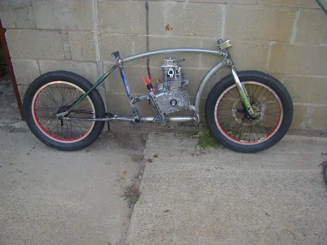

I dont think Ive ever started a "build" thread on this forum.....here is my big bore gasser bike to haul out to cali for the 15th at Bairdco's event (my summer vacation)
Engine starts as a typicle preditor 212 6.5 hp (on sale for $100)
mods:
remove governor
Add a decent flywheel to take the new rpm limits (bmi steel unit $60)
upgrade the con-rod for the same reason (standard billet ARC $65)
upgrade the valve springs ($10)
upgraded parts are more $ than the motor...go figure LOL
future mods:
Add a fire breathing cam & a big ol' carb to get some air flowing thrugh the engine.
I dug into my pile of salvage frames to chop up & brazed it up today. looks a little like this:
I did roll the top tube & downtube into a more pleasing shape.
the geometry is 23deg steer angle & i'll shoot for 3ish inches of trail
wheel base is dead on 48"
Things to do this week:
get the chain lines situated & weld on corrected front drop-outs for the trail #s (the front wheel is not mounted in the above photo) & add disc brake mouting points front & rear.
fab up a carb adapter to use the stock carb.
I'll be running a Hilliard clutch & a little mojo to the rear wheel #35 final drive chain.
I'll post more as I have it....I find it doubles my work time taking decent photo's & frankly I forget to snap pictures at the best times.
I have a cam & some race springs for it...but the preditor has a little larger journals on it than a typicle clone...Later,I'll bore the journals & insert bronze bearings to the standard sizes so I can try any clone cam I desire.
any questions for the supposed e-bike nerd?
