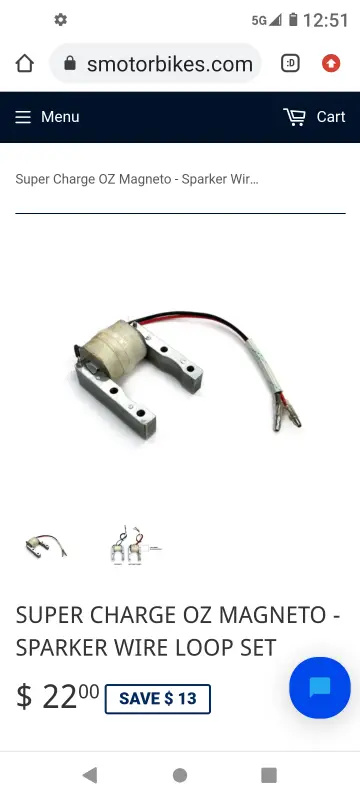

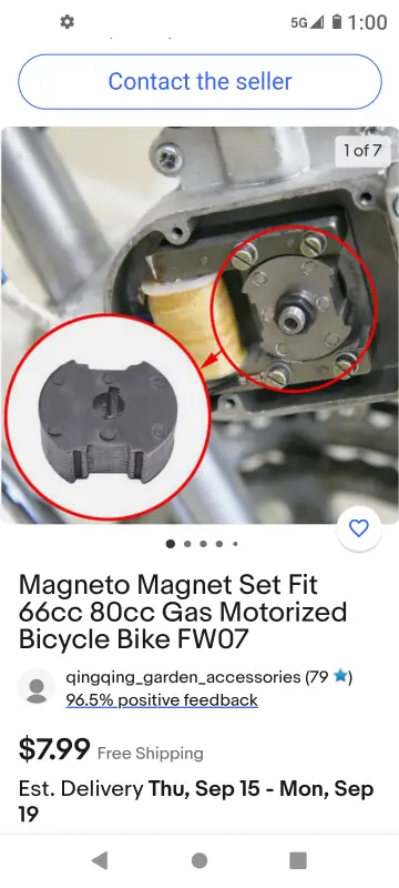

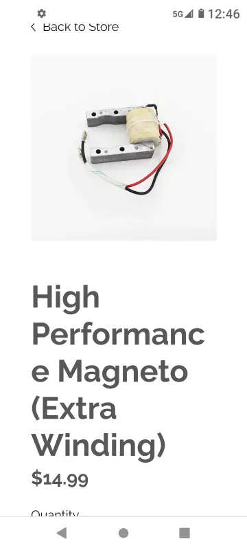

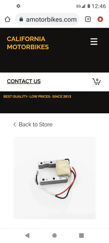

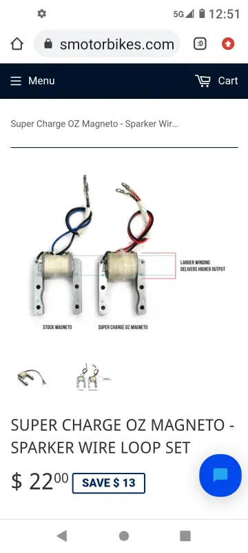

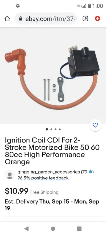

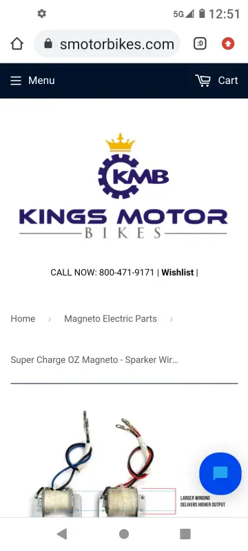

As a rule I replace the mag with a 12v or fat boy one and the CDI with the tall tz one and the plug wire with an automotive type one with a boot on it... heat shrink connectors you can rewire everything with 16ga wires the magnet has an upgrade stronger one... You can adjust the timing with a shaved down key or a star washer with a tab bent over to hold it on... Ngk B7HS plug... Gapped at .028
Mossy
May 20, 2022
1,128
819
The first 2 come from the same place the hex boot CDI is the latest one and assuming the new magnet is the stronger one the fat magneto from kings is the one I would get... These companies are constantly up grading and going in and out of business... But as of today these are the ones available

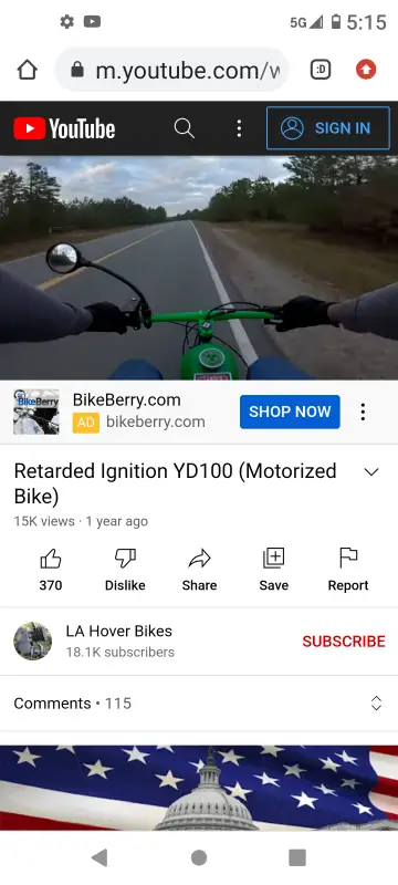

Could be a bad kill switch... Intermittent shorting... I got tired of chasing problems and go through everything... The challenge is to get it reliable check out LA hover on Utube he has a bunch of videos on the 100's
