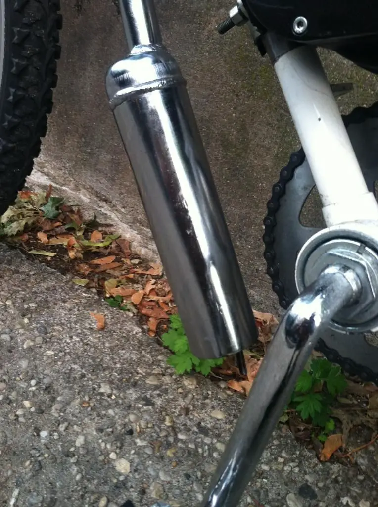

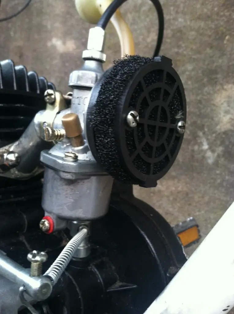

Hey guys Im glad to say I finally got my bike up and running after a long winter, and It was running normally until I made 2 modifications for power.. both pretty self explanatory.
So it was running better than ever the other day.. I hit some crazy speeds. I ended up flooding the carb so I drained it. But the bike still just starts up, and bogs down. The throttle does nothing
Maybe could be a spark problem? The boot is a little shaky & I think came apart on the plug :-||

Also, have you messed with the jet on the carb? It could be loose and constantly flooding the bowl. Happened to me once, couldn't figure out what it was for a week.

The first thing I change on a new cdi is the boot, I buy NGK boots at the local motorcycle dealer for about $3 each. Are you running without a end cap on the exhaust? If so you probably need a bigger jet because of the lack of back pressure.

These engine rely on exhaust back pressure to keep the fuel mixture in the cylinder, you need to do a plug chop but that's going to be hard to do if it doesn't run above idle. The jet that is in the carb is usually a little on the rich side with a stock pipe that has the end cap on it. I have had to tune every one of my bikes to get the right mixture. I have a micro drill bit set that I use, I drill out jets if i need to. On one I had to solder up the jet and drill a smaller size, it all depends on sparkplug color.

my bike ran fine without the end cap. you flooded the carb while riding i assume? maybe too much fuel in the base of the engine? if so, that should clear after a few days at this rate. also check all the passages in teh carb for debris. not uncommon for crap to make its way from the fuel tank (because thay all come spotless ya know) and get stuck in teh carb.

The nt is a very simple carb, take it apart and check everything. Check the main jet because more than a few have come loose or were left loose from the factory.

The air filter might be to close take it off and start it up see if it runs normal, I had this happen with mine when my origanol cleaner broke. when its to close to the intake it doesn't let enough air through when u give it throttle
