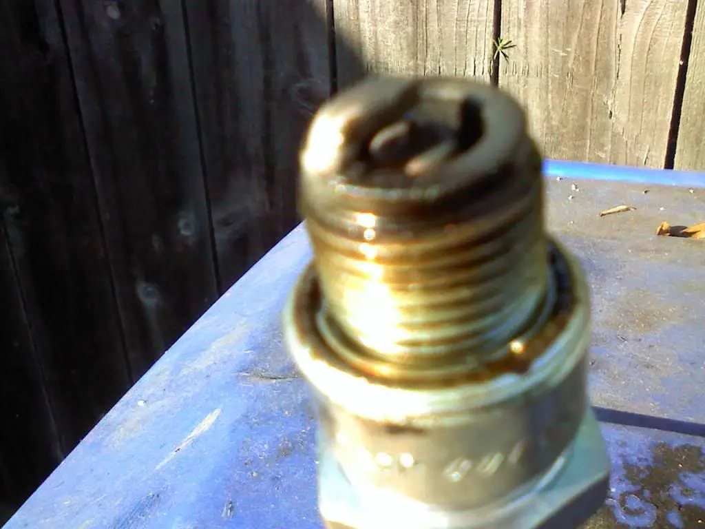

I don't understand this. I dam near had my bike running perfect. Only trouble I had was the vibration at really high rpms. I did a plug chop and I know I have to be running way to lean. The plug still looks new except for the burn marks on the tips, where the spark ignites. The white ceramic part is solid white. But remember its running good. I then go up a hair on the jet and I'm still running lean but now my bogging issue is back. I just know if I keep going up on the jets to a richer proper level then the bogging will just get worse and worse.

Sry, I didn't see your post, killercanuck. Here are some pics of my mounts and my plug that I had mentioned above.
The piece the arrow points at, I'm using as an extension and is the only thing different from my old setup.

I'm still having trouble with getting the fuel mixture right. I've drilled out my jet all the way to a .8mm and it's stiil running too lean. It just won't get tan or light brown on so short a run. If I leave it in for a week, while driving around daily, it will.
Let me explain what I'm doing on my plug chop runs, maybe I'm doing something wrong. First I drive to a secluded road down the street. This gets the motor at normal operating temperature. I remove my normal plug and put in a new plug. I peddle up and let go of the clutch and quickly accelerate to full speed for about 600ft. Right before the end of the road I hit the kill switch and pull in clutch at the same time. I turn around and repeat for the way back to the other end of the street, just for good measure. I then pull over and remove the new plug and put back in the old plug.
I keep going up in steps on my jet and each step up it don't seem to make any difference. Although yesterday it did sound like my motor back fired one time right after I hit the kill switch. I was at a .7mm then on my jet. Today I decided to go up in big steps untill I get close. I went up to a .75mm and then a .8mm. From what I understand this is a big change an I should be running too rich at .8mm.
I live in a very humid environment, so close to gulf as I am. I live in Houston, Texas. Could this be a factor in my fuel mixture problem?
The motor runs fine, I just don't want to run too lean and damage my motor.
I'm also using 32:1 Royal purple synthetic oil 2-cycle TCW III with super unleaded.

A good safety regardless of plug reading or measuring head temps ect is to adjust mixture so that you get a very slight intermittant 4 stroking at full rpm and speed. This is the old school way to adjust chainsaw carbs to keep from burning up the motor. As long as you hear slight 4 stroking you know you're not running too lean.
You shouldn't remove or replace plug while engine is hot. The aluminum threads will suffer and soon fail.

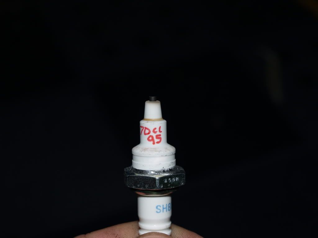

here is an example of my 2 stroke chops, note I was always told to look for the smoke ring deep in the ceramic for main jet chops
the normal ceramic you usually see is the lower jetting like the needle
See the tiny smoke ring under the threads I cut off but the tip has a touch of black
this jet was too rich
I ended up at 87 I believe they only went 80, 82, 85, 87, 90 so I didnt have too many to choose from
Stock was 80
this was after 2 weeks, note: it looks what is considered good
tan on the ceramic, hard to see
