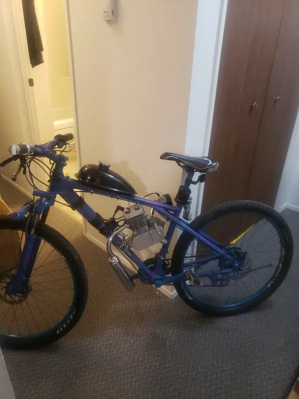

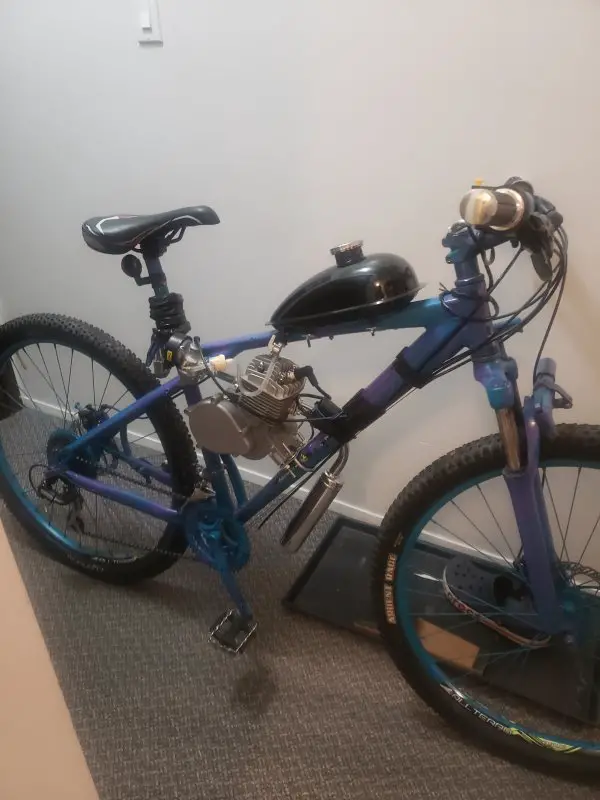

O it did!!!
iv got everything set up right,,, i think ,, and it wont start ? i checked the wiring, plug and fuel everything seems to be in order ,, wats up?
