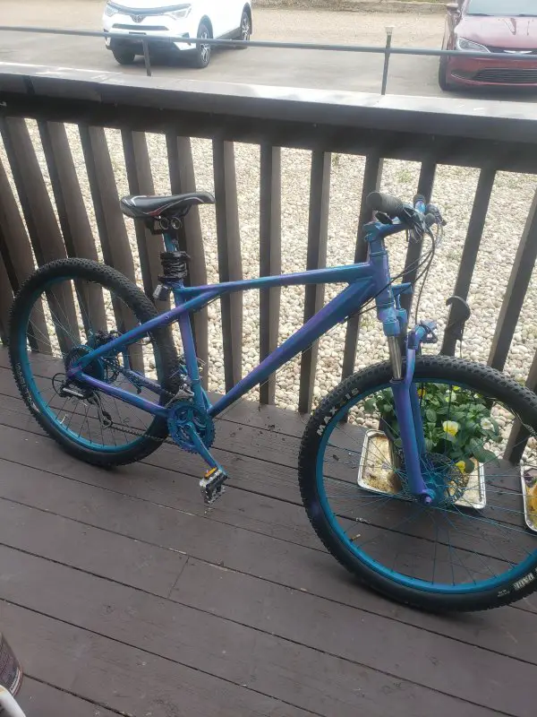

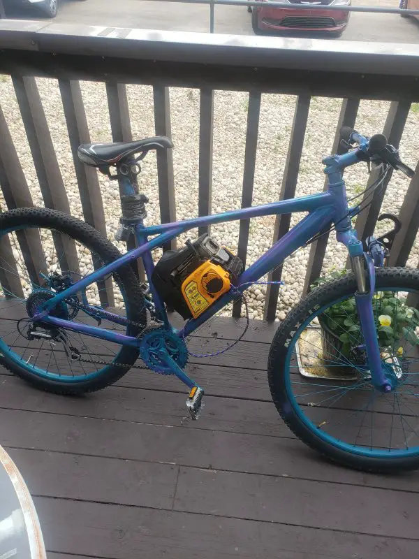

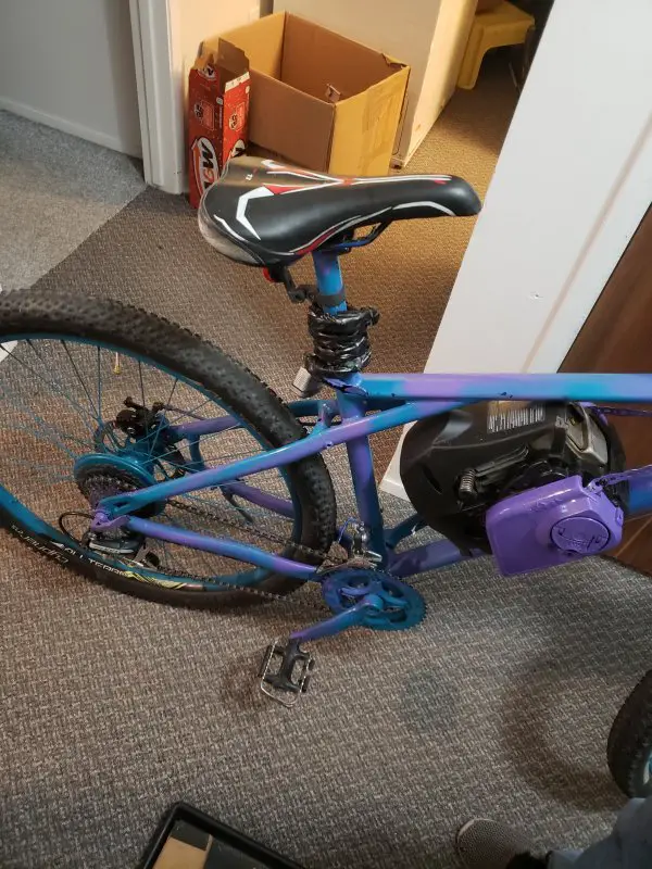

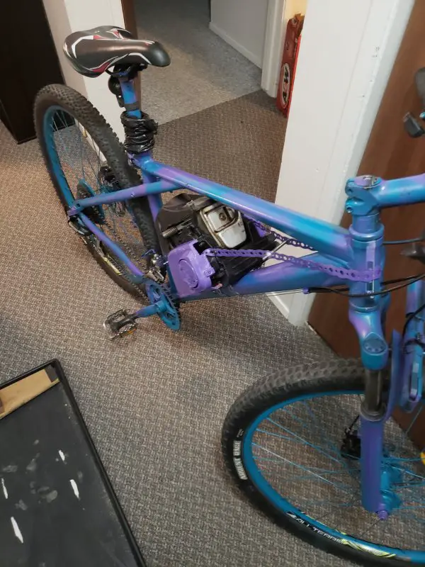

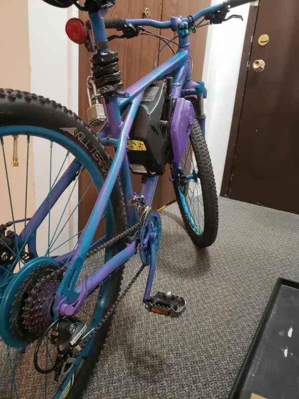

This is my first time building a chainsaw bike and im having trouble figuring out the best way to hook up the chain from my 42cc poulan pro to my aggressor gt 7 speed with 14t-34 t with the least amount of frame modifications possible and the best gear ratio. Any advice???
Are you wanting to do a left side single drive ratio? Or are you trying to run through the bicycle gears like we shift kit builders do?
I want to use my gears i figure it will b the most efficient im still at the beginning stage and don't want to screw up a $$1000 bike and don't want to waste my time on a **** one either but I get confused when it comes to the gear ratios
Its a tight fit and no room for any kind of shock absorbers on the motor but I think I have that on down now I need to figure out the best way to mount the drive chain and still utilize my gears
If you paid a $1000 for that bike. Somebody stole a high dollar wheel off the back and replaced it with a 7 speed 34-14 freewheel (34,24,22,20,18,16,14). The higher end bikes use 8 speed and up cassettes instead of freewheels. It kinda of looks like a Kent frame and a blue spray paint job.

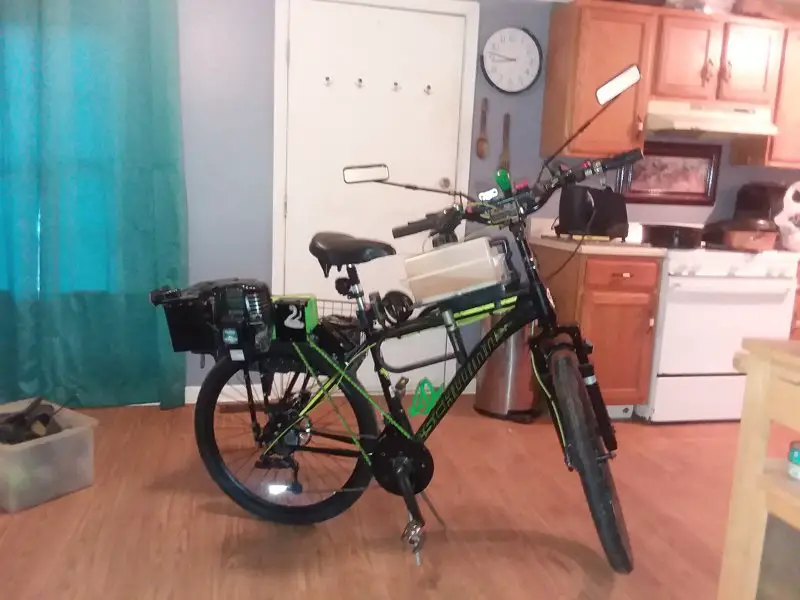

On my bike I use a custom built 7 speed freewheel (34,28,24,21,18,15,13). I also have a Staton Inc triple chainring shift kit. The chainrings are 28,36,44. I use a 4 stroke Robin Subaru 35 engine [33cc 1.6 hp]. The engine is ran through a Staton Inc 18.75:1 reduction gearbox. The RGB uses a 15:44 drive. The reduction range is 66.79:1 to 16.25:1.

I'm a large person and live in the mountains. The bike I built didn't come cheap.

Wow thats awesome man but I'm not really looking to go all out on this i just need to no wat the best way to mount the chain for reliability and simplicity i don't really have the capability to make parts or even understand pretty much anything u just saìd im just getting into this .. And lol the bike is a 2019 aggressor gt
So are you wanting to do a left side single ratio drive?

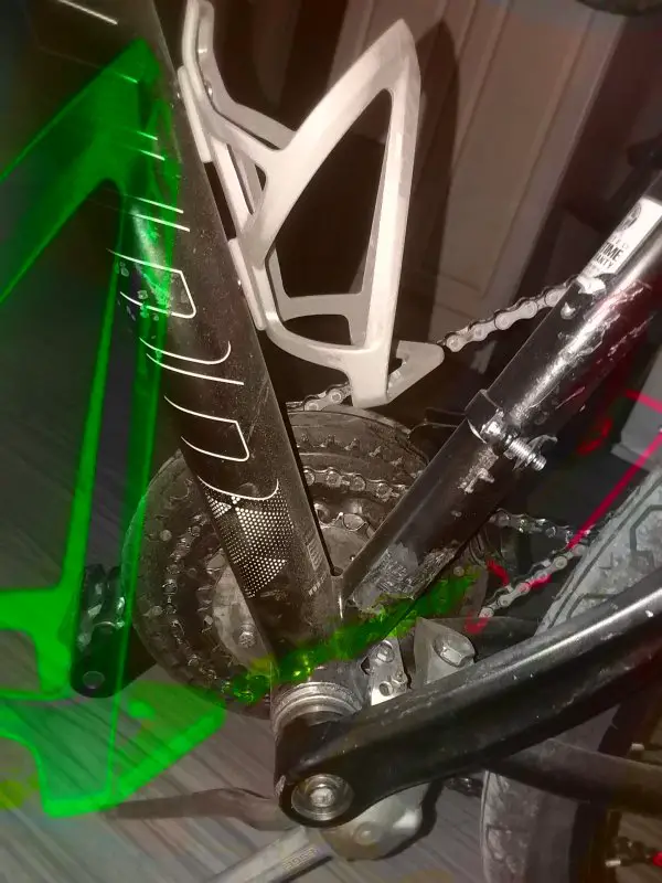

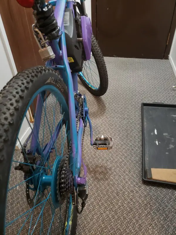

No I was thinking about sticking to the right and maybe trying something like a jack shaft i want to still be able to use my peddles and gears. And thanx no one has ever explained how it works to me I just switch to whatever gear feels easiest at the time
If I knew wat the **** that was LOL this is wat im working with i want to keep the rear gears and utilize the pedals so I can still use it as a regular bike. SIMPLE BUT EFFICIENT. Thats what I'm looking to achieve

Ya now that i took closer look at it thats exactly wat im aiming for exept i am mounting the engine in the middle hope its guna work out like i kinda have planned... maybe
So what would my optimal gear ratio be to keep top speed and still have climbing ability what gear would I put on the motor And the rear 7
And without changing The ones I have in the back what would I use on the motor rate now I have 14 16 18 20 22 24 and 34T
Ok first you need a reduction for the engine. Chances are it turns more than 8000 rpms. So the rear wheel can't turn that fast. You'd also need a shift kit. I use a Staton Inc triple chainring shift kit.
Here's a video of Fabian building a triple chainring shift kit using a Sick Bike Parts shift kit.
You can't run through your gears without a shift kit or the pedals will spin every time you use your engine. Much too dangerous. You can run a left side jack shaft. Then to the left side of the rear wheel. You'll need a better centrifugal clutch. Use a 9t sprocket on the clutch and run to a 36t sprocket on the jack shaft. Then put a 9t sprocket on the jack shaft and run it to a 36t sprocket on the left side of the rear wheel. This'll give you a 16:1 reduction.

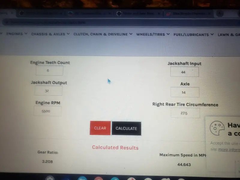

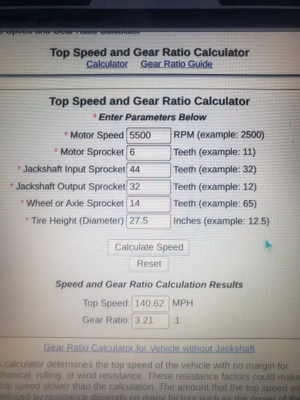

Ok thanx and do u know what that would give me for top speed? I'm aiming high, looking for something around 70km/h with maybe 5-6000rpm range on the motor is this possible? I'm getting conflicting information about this i want to Use a jackshaft to the gears on my rear tire with these specs 6t-44t motor to jack input and 32t-14t output to rear tire and it gives me a ratio of 3.208 with a top speed of 44.643mph BUT.... then I get this ..... y would it be so far off with the same gears??????
