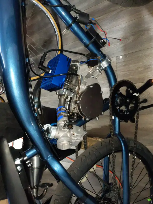

The only other reason i could suspect it not starting at this point is perhaps the reed valve stuffing plate was installed backwards. I will check today...

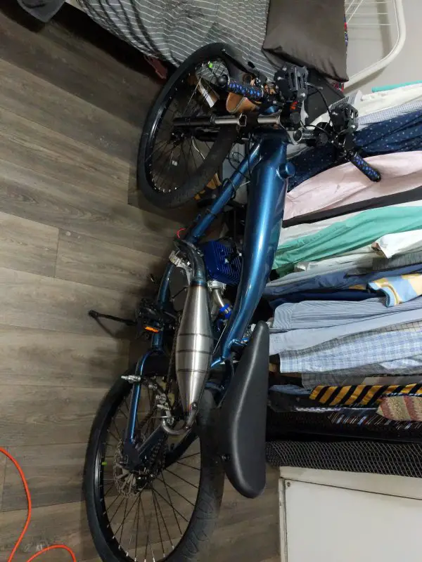

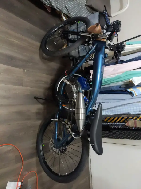

Sorry I guess it helps if i submit some pictures of the build. so here you go.....
Photos of bike

Still no luck. Tried exactly as he suggested. Checked voltage on two cdis and magneto all read clearly? I also tried both cdis ignitons, two spark plugs, NGK BR8HS and B5HS. No spark it seems. Magneto and magnet have been aligned by a piece of paper folded in x4. So there's equal distance between them both. Tried adjusting the carb numerous ways with no luck. I also asked Break Build or fix it to demonstrate a video of his carb working. Specifically the Nibbi pe19mm.
Checked torque compression of head. Gaskets flush. One bolt came out taking out the nut. I flushed the bolts all the way to the bottom of the crankcase previously before install. Noticed the head wasn't seated fully recently. Removed the head checked the surface and gasket both fine. Only other thing I can think of doing is leaving the gasket on the stove for 5 minutes then placing it on and tightening it
Tries stock minarelli head. Changed magneto after checking spark. Engine hesitates to turn magneto without power drill. Got spark on Another magneto. Compression was OK, torque 12ft lbs with torque wrench. Tried stock minarelli head. No difference in starting.
