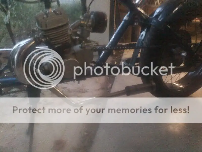

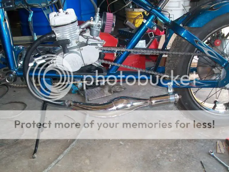

added a pocket bike pipe and silencer today..added a little bottom end power..alot of midrange and a little topend..just from the feel i would say 3 to 4 mph but the best thing is the midrange pulling power...next step is a billet intake from jim.
pic makes it look like the pipe hangs out a lot but it doesnt.

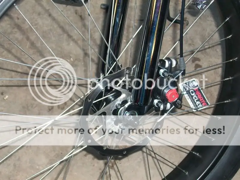

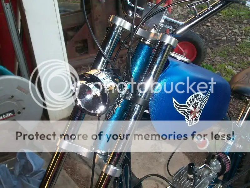

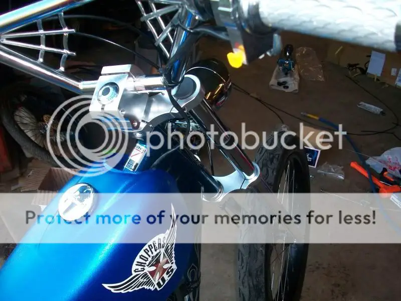

another addition made today..3 inch wide tire,2 1/2 wide wheel,front disc and new forks with aluminum trees..rides much smoother and the stopping power is unreal..here are a few more pics..hope you guys enjoy seeing build pics as much as i do.
I like it alot, looks unique and very much custom thats for sure! I like the rear saw blade disc brake and your mount, very nice indeed! maybe the exhaust would look a bit more smoother if you took out some of that radius in the pipe!, I would tuck it closer to the frame, and then out the back like you had it. but looks real good! here is some pics of a build I done and I tucked the pipe close as I could and because of the long pipe it has a torque but no good top end, 27 mph w/ tailwind.

its a photo illusion,the pipe is in further than the outside of the motor and runs much better than before.
