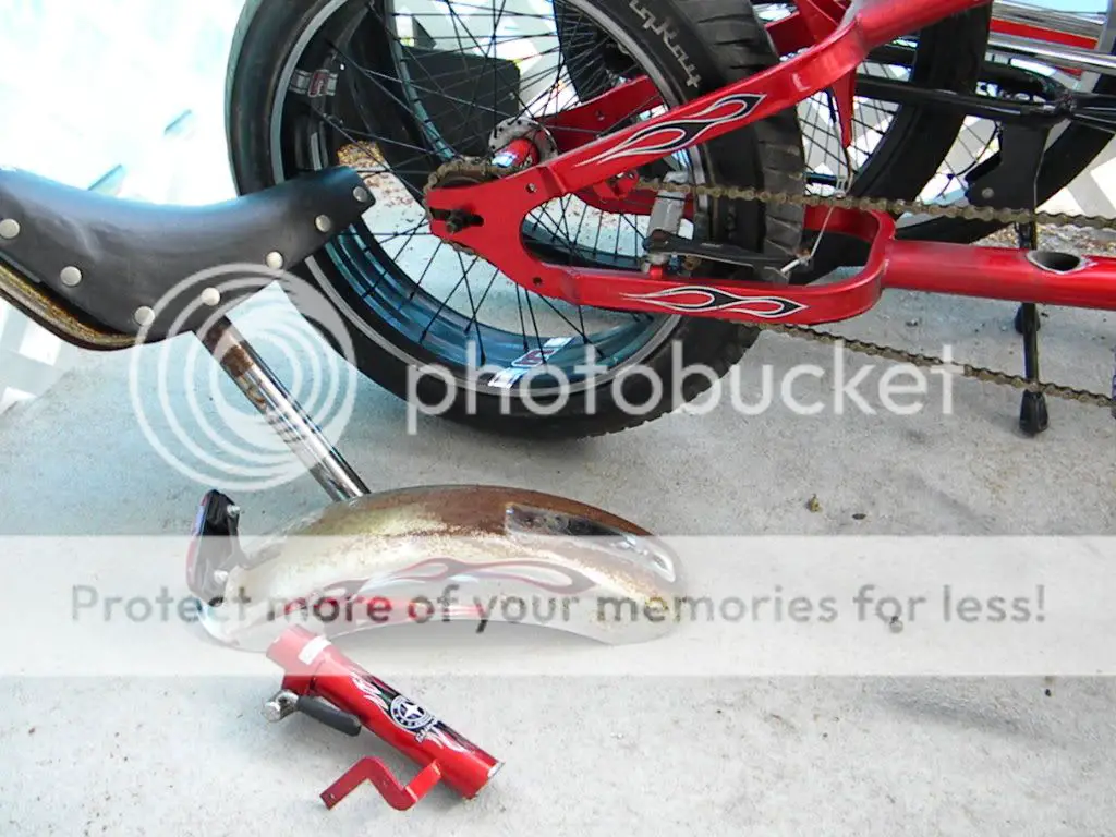

One of the first modifications that I had to make is removing the seat down tube, removed it with a 4-1/2" grinder using a cut wheel, if you don't have one you can pick one up at your local harbor freight tool stores for around $18.00 USD make sure you have 20% off coupon get the extra savings, just have cashier ring all your item's separately.
Here is the Link for the harbor freight 4-1/2" Grinder:- Harbor Freight Tools - Quality Tools at the Lowest Prices
I save the seat down tube just in case it's needed later! I made the mistake of throwing away parts before only to have it haunt me.

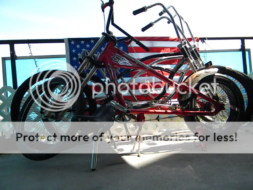

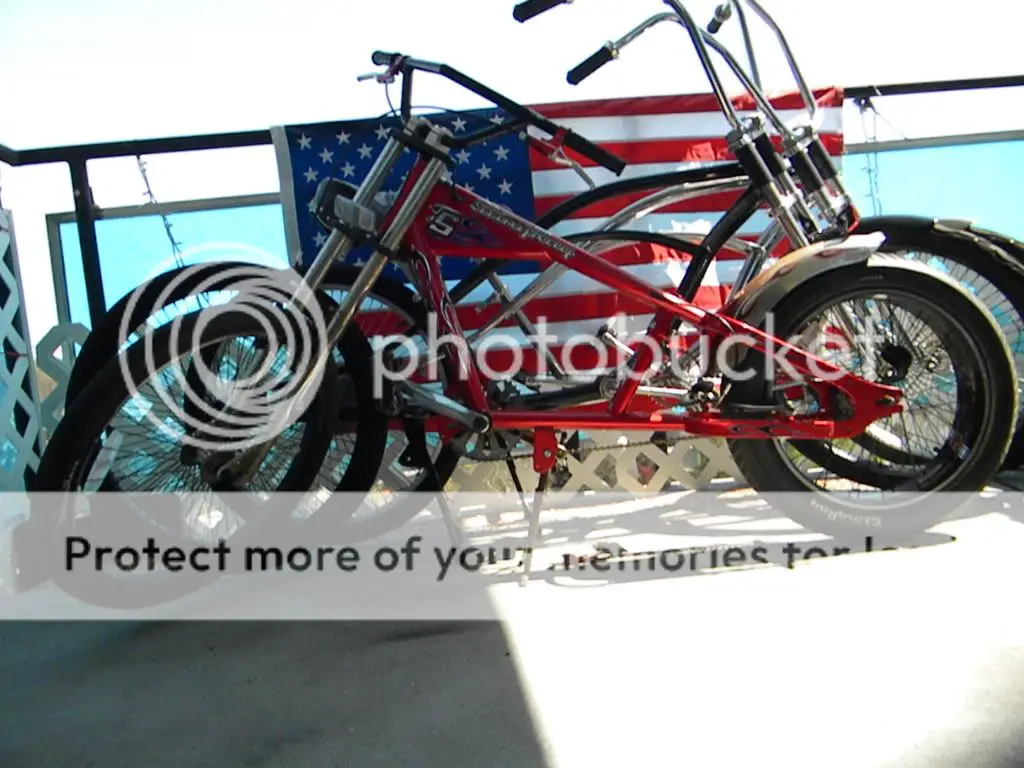

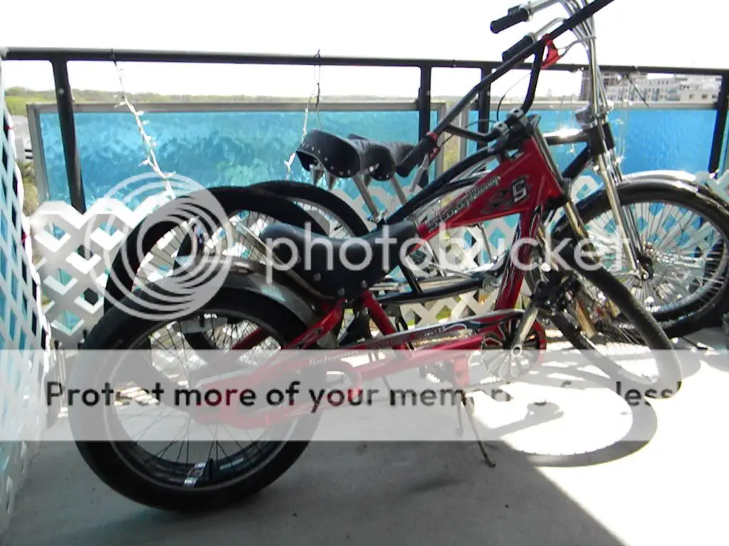

Here's a photo of the XL-Chopper, I would guess the XL means extra long;
Here's a photo of the stock OCC-Stingray Chopper:
Notice difference in length of the bottom tube compared to the bottom tube on the XL-Chopper!
Here's a better photo of the XL-Chopper:
Last but not least my OCC-Stingray Chopper:
