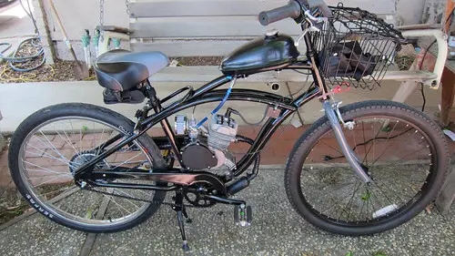

Well...I went and ordered me an extended muffker from BGF. Anyone have any experience with using an extended muffler or poo poo muffler on this particular OP frame? I am hoping it mounts right on and does not interfere with the pedals. I also hope that it does not affect the performance too much as it has been running real nice.
The muffler worked out pretty well. I like the way it sounds and it looks great if you look past the ugly welds,lol Allready thinking about what my next bike build will be.

No problem, I speaks the truth.
The only thing I like better about my bike is the engine mount position in the frame. I worked that over 4 times I think. The frame has the scratches to show. Other than that, you rock!
Well that is a pretty nice ride you have there yourself. I agree with your motor position. The way you did yours looks more like it was made to go in that frame and fills out the empty space better then mine. Looks great!
