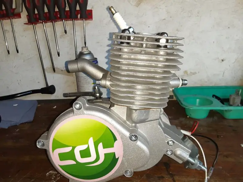

my 100 cc motor came in today was packed real good and after examination no breaks or flaws detected......happy camper here

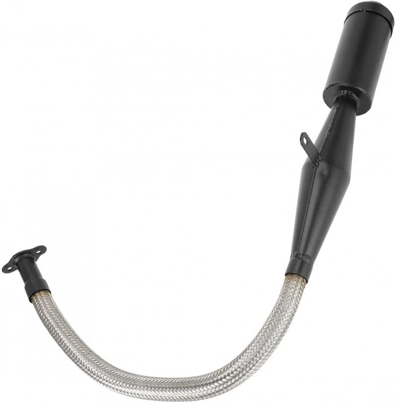

i was thinking of buying this muffler but if any of you have a better option i am open to suggestions . when i saw this one i was thinking to run it along side the bike on the opposite side of sprocket. it has a expansion chamber and from what i been reading that is the way to go with a 2 stroke .

Gill the pipe on my bike I ride the most works good, it didn't increase top end much but helped bottom end to mid-range a lot, I welded a stock muffler on as a silencer.
Gill cannonball2 has been riding a yd100 since early 2020, he is the first I know of to get one here on the forum. He is running a similar pipe to mine, I think he is happy with his as well. What I've learned about exhaust pipes on these little engines is the head pipe length makes a difference in torque on the low end, my bike climbs hills now that it wouldn't before I installed the pipe.

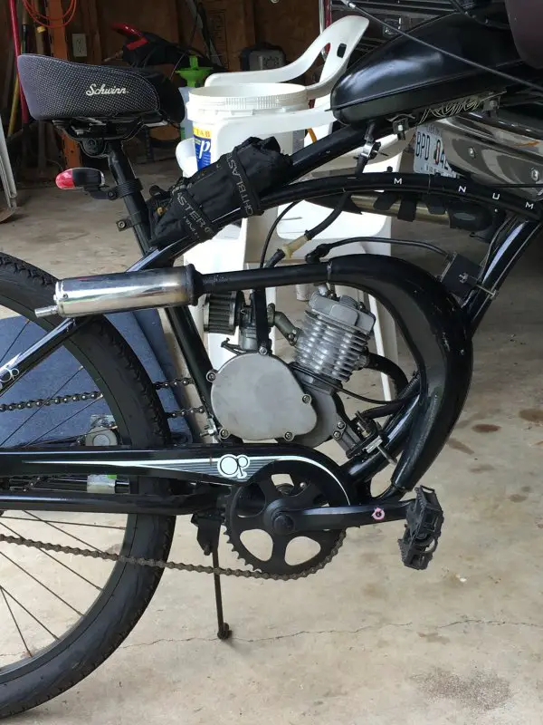

The bike in the picture is a little 48cc, it tops out at 31-32 mph with a 44 tooth rear sprocket, I have done a lot of work to get it to run like it does, stock it was slow. Today’s stuff should be better, that engine is 10 years old.
