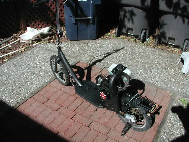

I have a Mosquito Stinger stand up scooter. The King of stand up scooters, I loved to smoke all the teenagers with it. Sixteen inch bicycle wheels, drum brake in back, V brake in front. All aluminum. Has a 40 cc 2 HP 2 stroke motor with integral 6:1 gearbox.
But the motor has this high speed drop out problem and I don't want to tinker with it anymore. Not to mention, it is loud and obnoxious. So, remove the existing stuff and build a motor mounting plate with a jackshaft underneath and redo the whole back end.
It was either that or build a bike and I already have another bike project lined up.

Got the motor off and all looks good. Looks like I can stick the jackshaft in the box. That box is strong, 3/16" aluminum, with about 1/2" thick where the motor was mounted. I will use these holes to put in a quarter inch aluminum plate to hold 1 standard 5/8 x 1 3/8 bearing and the other one I'll just cut a 1 3/8 hole in the side of the box.
That will keep the jackshaft under and independent of the motor mounting plate. Looks like there is easily enough room for the HF 2.5. There is 14" from the front of the box to the end of the "fender"

Yeah, this'll work. Even looks good. I feel like Tim Taylor...more power!
