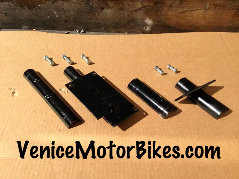

Looks like Venice made those mounts, That's the way I'd go.
For alloy billet mounts, you want to look for the ones they use to mount things on Buggies.
But for that engine, I like what Venice has done.
Yeah, I like those Venice mounts, very well built and they won't mess up your frame... can't go wrong going that way. Theon is right about the billet mounts and getting the buggie mount brackets, billet mounts do look cool, but the Venice mounts are probably the easiest way to go, and they look great too.
