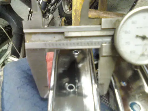

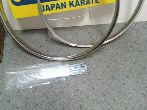

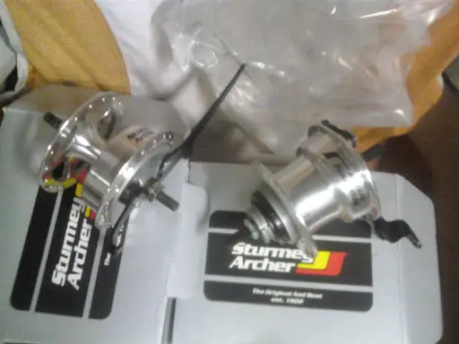

0K here the stuff i bought
here is the thickness
i guess it dont show up too well on the pic but it says 1.532 or so
still really wide compared to anything else i have. i think it will look pretty ol' school like i want

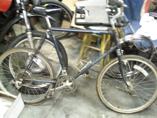

Alright! scored this killer schwinn tonight! my friends dad gave it to me fo FREE.
its gonna be a great doner for some parts i was gonna have to make/buy

the schwinn i got has a set of rims on it that clearly say 26x1.75
but they only measure a little over 1.25 wide on the rim
does anyone know if this is pretty standard and thats the reason my 2.125 husky rims are only like 1.5 wide
just slightly perplexed my mt bike rims say 28mm wide and they are exactly that
any thoughts?
Ya the rim width is narrower than the real tire width. It makes the sidewall squishier. (is that a word?) When you pull the jug make sure you look at the piston ring grooves. 2 strokes have a alignment pin in the groove so the rings don't rotate the ends into the port. On these motors the two pins go towards the intake side of the cylinder. Everybody's fins come bent, don't know why. Nice Rocky is it titanium?

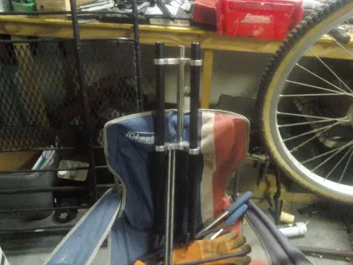

the steering was really tight when i picked up the bike and i just thought i needed lubed or something
but i was wrong the bike ran into something i guess cuz the steer tube was crazy bent inside the headtube had to use a hammer to get it out at all. i think you can tell its out of whack in the pick i have of the bike on an earlier post
i know the fork is junk. but i was wonderin about the frame , the headtube mics out good(its still round) and is straight according to my straight edge.
so question is- are the any unseen stresses here i should worry about or just get a fork and go with it?

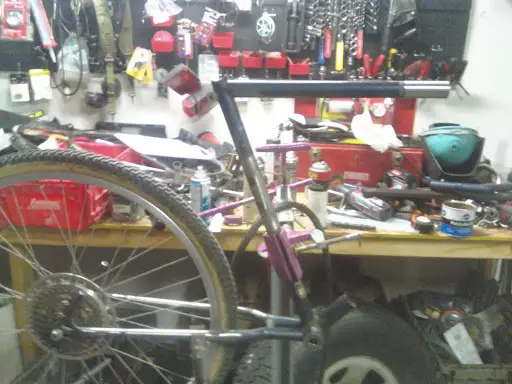

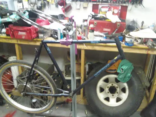

heres my current progress- actually got some cutting and welding done!
shortend the seatube by 3 1/4"
and got it welded back together. i cant believe how good i was able to make it look!

the frame is goin to have 2 top tubes like the boardtrack guys

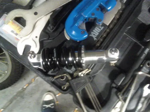

i have an idea for front suspension i want to get figured out
and will be using some flavor of the shift kit
had to shorten the seat tube so the old top tube will be the lower one and the head tube is going to get a slight raising mabey 1/2"-3/4" will get that measurement hard once i get a complete wheel stuck in my new fork

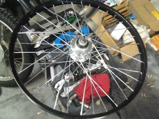

just a note bicycle wheels are a pain to lace up! i have done motorcycle wheels before no problem but those 11g spokes on that 3speed hub was a pain. im gonna have my LBS guy true the wheels up i hate trueing wheels its a total pain cuz i wont spring for a stand
remember! a pack of 50 spokes is not enough for 2 36spoke wheels!
had to order another pack from husky and pay $12 shipping again guess i got past that idiot moment
