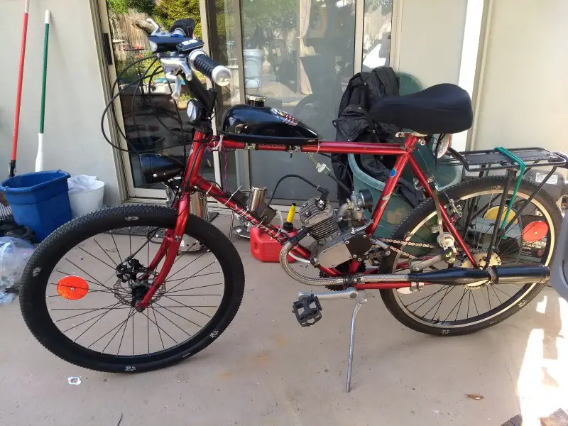

I know there are fancier and better looking bikes but much like my woman, I can say she is mine.

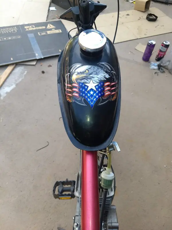

I started with the 26 in. specialized hard rock freebie from my buddy Stick and added an 80 cc Anbull kit. Which came with clear ports BUT also came with cylinder full of metal shavings from deburing the sparkplug orifice. Glad I looked!!! (Photo 1.
I added a niome

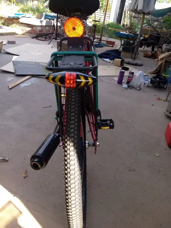

flex exaust with the custom swing arm for easy of swing away access.

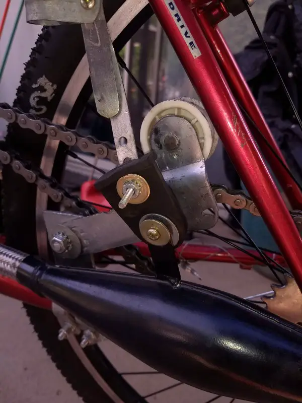

I used a rubber mounting gromet from in an espresso maker to suspend my mount flange on the tail pipe of the muffler to keep from snapping it off. And an old soup can to securely mount it out of the way.(Photo 2)

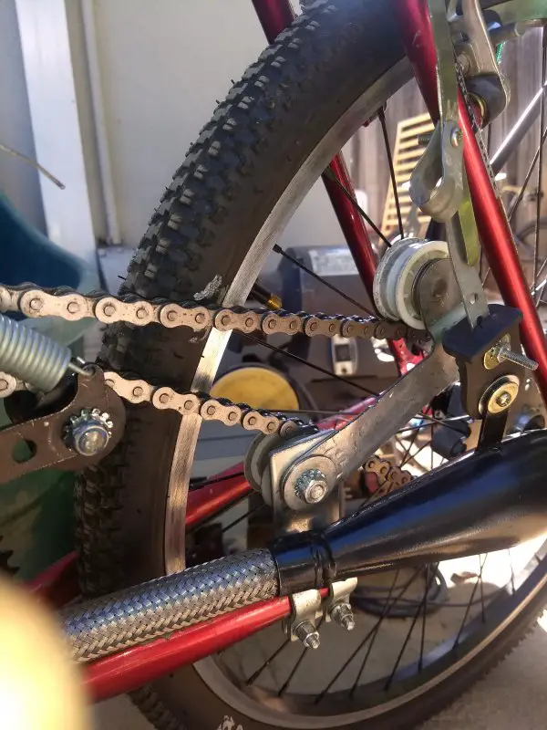

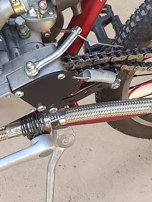

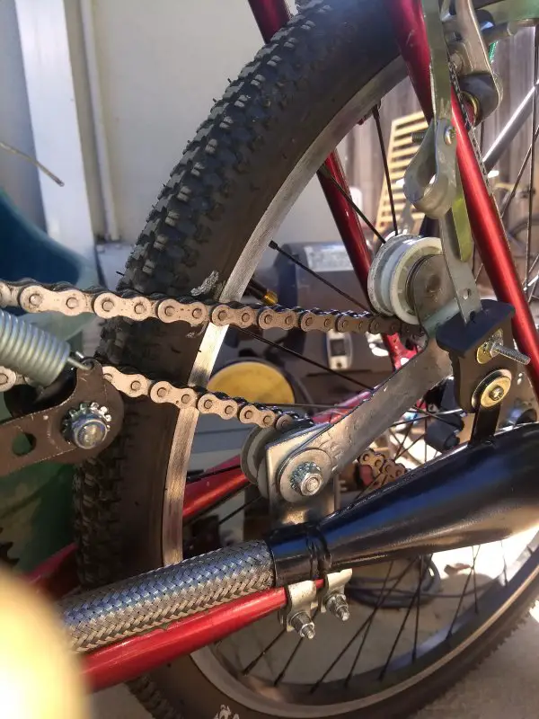

After market case mounted spring tensioner with the stock tensioner and one modified from a belt tensioner out of an old dryer, also swapping the springs STRICTLY for guides. The chain only touches them when the chain starts to buck or back lash. (Photo 3)

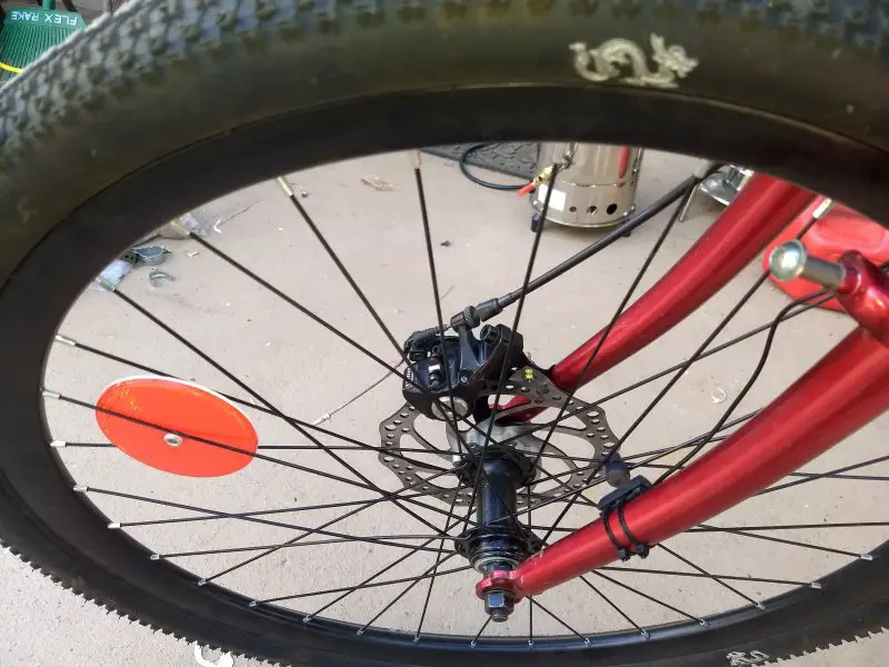

Front wheel is H.D. dual walled generic rim fitted with tektro mira 160 mm brake with ceramic pads.( Photo4)

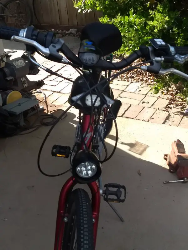

Redundant front lights which are battery and magneto driven powered with front and back stoplightw\synchronized turn signals and wheel reflectors. (Photo5.)
