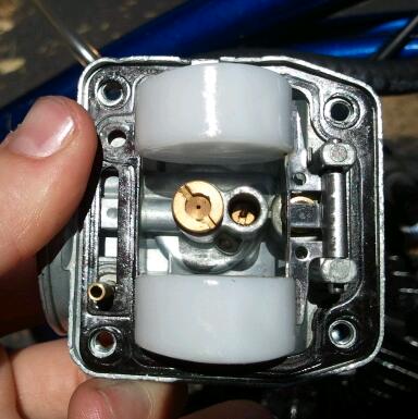

Hello, I just recently bought a 66cc sky-hawk bike and it has a Grubee Skyhawk CNS Carburetor. I've tried cleaning the pin and flipping the float but I cant get any other methods of fixing this problem.:-|| I am becoming quite frustrated at this problem. Please submit methods of fixing this problem.

The float adjustment tang is inside the float bowl under the carb venturi.
it's in the middle of the metal connector between the two sides of the float assembly and makes contact with the needle valve. VVVery little adjustments!!!!!

2011-08-31 12.28.25-1.jpgThe smallest out of the two tubes in the middle is the one you need to adjust right?
