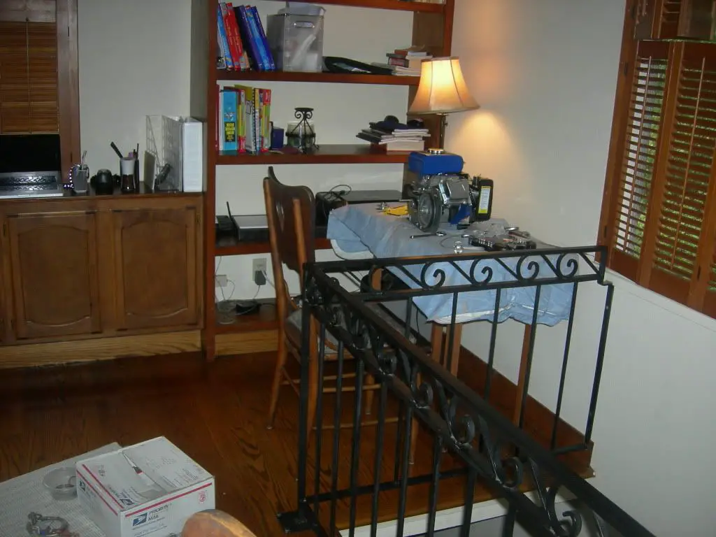

Hey Sam! How's your new school in California?
Wow! Somehow I missed out on this thread!
Schools going good. First year @ junior high, it can get confusing.
Right now I am sitting In my living room working on the H.F. Its a pretty strange sight!
Hey Sam,
Well we both have our Greyhounds sitting in the living room. I have the bike sitting there, too, along with tools and an engine mount I worked on today. What bike will your Greyhond go on? Mine is a 1951 Schwinn with a cantilever frame. I'll get my transmission toward the end of next week and hope to have it running pretty soon. I think it's a cool motor.
How's California? You like it?

Hey Sam,
Mine is a 1950s Rollfast straight bar. The rear chain stays are cracked, so I plan on butting them off and welding on a mountain bike rear triangle.
Right now I'm setting up the clutch. How do you plan to do your throttle set up?
Sam
(PS California gets better by the day!)
