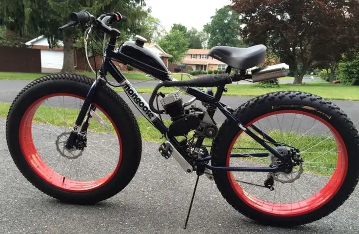

    I too am looking at one of the Walmart "fat tire" but am looking at the 4" wide tire. I'm very worried that there may not be enough clearance for a strong, 2 stroke the way the top tube tapers. Looking to do a jack-shaft as well to take advantage of the 7 speed..(It's a Mongoose) 21" top bar, 24" bottom bar, and 11.5 rear bar.
    Any body have experience with this one?

    What about this one?
    https://www.walmart.com/ip/26-Mongo...Fat-Tire-Mountain-Bike-Navy-Blue-Red/29741123
    Or was that the bike you were thinking of?
    Anyway, a good number of people have motorized this bike and it holds up pretty well for a mongoose, plus, it comes with disc brakes!
    This is a picture of one motorized that I think is exactly what you want, except without the 48cc, you want a 66cc don't you ;)
